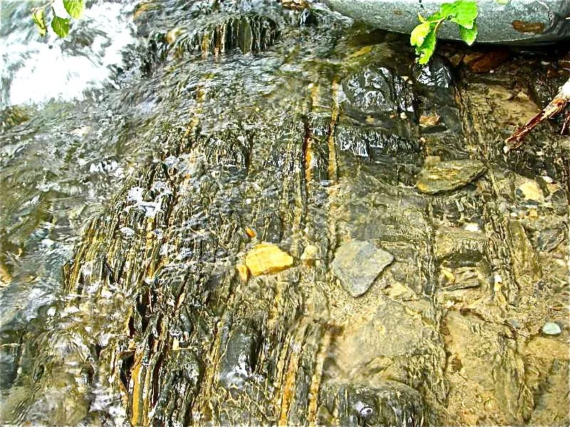

Good advice Aloysius. You're so right about the signal changing. I also liked how you introduced the concept of a nugget on edge--well done. As you've mentioned the different angle approach for pinpointing is very effective. Furthermore, just a bit more information for those just learning about coils and target location. Using the edge of a coil can be a great pin-pointer. If you're using the nose of an elliptical coil--it also works as a pinpointing aid.
What I mean is that when you get a signal, like I did when I got the bump signal right over the bedrock in my earlier post, and after I'd removed all of the accumulated soil and debris, I was then able to get what I'll call a faint signal (one with a beginning [low], middle[high], and an end[low], as I moved across the target. The problem with this is that the bedrock where I hunt is often jagged. This results from standing vertical touching sheets that have had the standing edges broken either by nature or by man. So, what you're left with is a place that makes pinpointing with the flat (bottom) surface of the coil very difficult, or almost impossible.
How do you resolve this? Well, you have to turn the coil perpendicular to the strongest part of the signal so that only the edge of the coil is scrubbing the ground (after you've crossed it back and forth from different approach vectors [crisscross] and have approximated as closely as possible about where the middle of the genuine "tone" is originating from). Then, keeping contact with the ground, you run the edge of the coil across your signal target "tone" zone until you locate the strongest area of signal location using the edge of the coil. (You should now have a much smaller target area.)
This technique will narrow down that original large target zone to a much tighter target area. Next, you cross that signal location at right angles using the edge of the coil again to find the strongest area of signal, and by this repetitive process you'll now you should be almost right over the target. But, if the bedrock is very jagged with gaps and dips, this is where the nose of a small elliptical really shines.
Now take the nose of your elliptical and put it down in the bedrock gap (if a gap is the location that results from your crisscrossing elimination tactics), and if the nugget's down there, the signal will get noticeably stronger. Dig the target gingerly as too much movement and force or prying of the sheets will make the target drop, and sometimes that drop is forever. But, if you're careful and use slow caution, you'll often retrieve the nugget this way.
However, sometimes there's another problem. How do you get the nugget out of there without it dropping into oblivion between those vertical, touching sheets of bedrock? For, when you pry the sheets apart to get to the nugget, the widened gap often lets the nugget drop (the heavy nature of gold manifestly at work here--it drops extremely fast once moved and granted some liberation).
I'm not sure of the most effective way of retrieving nuggets trapped in this fashion. Anyone got a good set of techniques for stopping the nugget from dropping into a rocky tomb you can't retrieve it from?

This is a picture of what I mean when I talk about vertical sheets of bedrock. Each one of these will pry apart. I have found nuggets, pickers, and flake gold trapped in rock formations like this. In this shot, this bedrock is right by the river. When you find detecting bedrock a hundred or so feet above the existing channel, where an old channel ran, sometimes you can find nice groupings of nuggets that the old channel caught eons ago.
