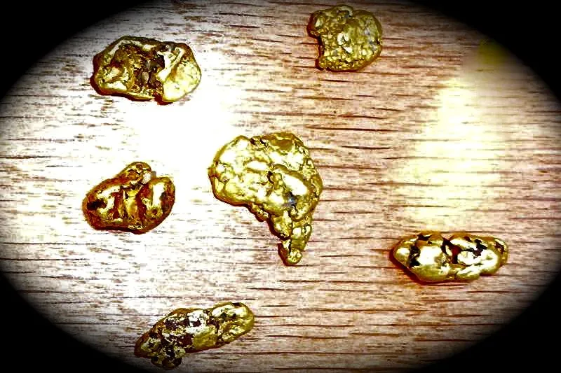

To continue my previous gold tale of nugget shooting up north . . .
About a week later, we went back to the claim where we’d been invited to wait out the rainstorm in his cobbled together trailer. As a matter of fact, all over that claim, the friendly placer miner had been digging narrow excavations (no more than two to three meters wide) and working the dirt from the grassroots to the bedrock. There was only about a meter to a meter and a half of paydirt, and the bedrock was soft and flaky. It was very different from the bedrock on the corner of the claim.
If you’ll remember, the bedrock on the corner of the claim had a bunch of bedrock with conglomerate filling the crevices (Conglomerate can be fascinating stuff. Sometimes it holds gold—sometimes it’s barren, just like river-run. If you don’t know what conglomerate is, it’s river-run that’s been stuck together by Mother Nature’s brand of cement. And, it’s good stuff too—very sturdy.) That bedrock was iron tough, and red hot. I had to run the detector (the 2100 technology was brand-new to me back then) on one side only—too hot for both sides, and far too noisy. And, if you chipped any of that bedrock, it would draw weakly to the super-magnet on the end of my pick. That mother rock was laced with iron—not solid metal mind you, but enough iron to mess up the signals and just enough to be attracted to the magnet.
Anyway, that piece of bedrock was right on the edge of a drop-off. The bank ripped steeply down to a little creek choked with short brush, about forty feet below. I kicked a loose rock over the edge into the water, and something went tearing off through the bush—most likely a deer, as anything more aggressive would have been long gone, what with all of the noise we were making. Glancing down the bank more attentively, I noticed that scrub pines, fir, and alders clung to every little ledge on the way down, but the rest was jagged, broken slate. Not a nice place for a misstep, that’s for sure, and not any kind of place to be detected. So, I went back to detecting the hump.
It had rained off and on for a few days, but the sun was peeking out now, and with it came the northern hordes—the ubiquitous black flies, mosquitoes, and horse flies. So, with practiced quickness, we drew out our bug dope and liberally doused all exposed skin, and ensured there was a liberal coating down in our ears as well. Nothing itches quite like a black fly bite down in the ear canal where you can’t get to it!
Regardless, we doped up and continued detecting until we ran out of signals (you’ll remember that we chiseled out some nice, sassy nuggets from ancient, cemented crevices in that spot). Well, now we had to look for new ground, and I’d recalled those trenches right on bedrock. I got the claim-holder’s permission (He always told us we could detect his claims—but I always double-checked. As well, he never wanted any of the gold we found—he told us to keep it all because we were working so hard to get it. All he wanted to know was where we found any nuggets.)
Well, I postulated that the best chance for gold would be on that bedrock, right? So, we hammered every inch of bedrock in that maze of trenches all day long, and guess what? Not a sniff—not a whimper—no zip, zip—no low-high Minelab “ew-woo-ew” either. Nothing. Well, I was stumped. He’d been getting nice nuggets from this ground—we’d seen them. I then took into consideration that the bedrock was soft, and that he’d taken a bunch of it up with each scoop, and run it through his wash-plant. (That wash-plant was quite a creation. He’d made his own spring-loaded screens at the end of his shaker trough so that the stones would consistently bounce right off and not clog his screens. Furthermore, he was energy conscious. Gasoline was very pricey that far north, diesel less so and more economical, and so he’d modified an old Wisconsin hay baler engine to run on diesel! Saw it with my own eyes—a gasoline engine running on diesel--cleverest thing imaginable.)
Anyway, as he’d taken up a good portion of that bedrock, and it wasn’t the kind of bedrock to hide crevices, I got out of the trenches and got up onto the flats where he was working. Guess what I saw? Two large boulders that he’d pulled out of the trenches and rolled off to the side. My mini-brain had an illumination. Why not detect any dirt that had fallen from those boulders. Well, there wasn’t a lot of dirt to detect, but the nuggets were sure in it! Three nice, fat, northern beauties went into the bottle before the sun set that night.
Now, seriously, you’d think we’d have rushed back to that other claim where he’d pushed and pulled all of those boulders in that swampy bowl, right? Not!! Thinking back on it now, I don’t know what the heck we were thinking, but I’ve got another story for another day about the gold we tried to give to the claim holder—that’s quite a story of missed opportunity too.

now that's some good looking nuggets ! perfect for jewelry . nice character ,nice color .
Wow! Beautiful area, and I love the picture(s). I'd love to have a couple of those blue rocks too.
Just wondering, if they were cut for jewelry, does the blue extend all the way through them? I know that most that I've found over the years that are blue or green, are not that way through-out. The color is just a patina.

Thanks Strickman--it's absolutely gorgeous gold--very much jewelery grade. I think you can see why I'm kicking myself so hard that I didn't buy a jar of gold from that kindly prospector--what a treasure that would be at today's prices!

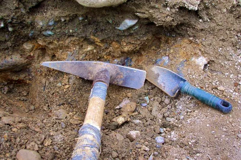

Just a few quick thoughts before I shut 'er down for the night. One of the hard lessons I learned about detecting (as you can tell from my stories there were way more lessons I didn't learn than I did!!) was not to go too fast when in heavily mineralized soil, and in all reality, not too fast whenever you're chasing nuggets in good gold ground.
The reason for this is that due to the severity of the ground conditions, every subtle change in the threshold can make a big difference as to whether or not you miss a target or whether you find a target.
I know this is quite a bit for a beginning nugget shooter to get their head around (you pros already know this stuff), but I've found nuggets in insane ground conditions, and the only way it happened was because I paid attention to the pros of the day that counseled me to go slow--they spelled it s-l-o-w on their posts so that slow learners like myself would hopefully catch on.
By the way, another valuable tip that went hand in hand with the go slow advice was to scrub the ground with the coil. Well, when you do that, it often bumps along the ground and you get false signals from the movement of the coil wire, loose components within the coil (if there's any), slack in the shaft transmitted up to the control box, the battery wire swinging around, etc. You get the picture.
However, by scrubbing the ground slowly, and by listening very carefully to very subtle changes in the threshold, that is often the only clue you'll ever get to a nugget cached in severe ground. (It truly does seem opposite to what seems natural. After all--get out there and cover as much ground as possible, right?) But, by going slowly you'll discover that it's rarer to get a loud, distinct signal (most often those are nails and other trash). More often in hammered ground, you'll get a "bump" in the threshold, a barely detectable change. Now, and this is where it gets important, you'll often get all kinds of false signals, but a bump or a definite break in the threshold will be there as you very, very slowly go back over the same spot again. In contrast, false signals, unlike bumps, wander all over the place.
Well, what do you do after you get a bump? Remove some of the soil over the target area, and if it's a good signal, the bump should strengthen into a whisper. This is a very faint signal that will be there as you pinpoint the signal source with coil movement. Next, you need to scrape away more soil. If the signal now gets you a tone, you're well on the way to finding out what's down there. (With the GPX 5000 now, and the variety of coils, programs, and the pinpoint feature, there's lots of ways to tweak this process now.) Yes, sometimes a clever hot rock will fool you, but you'll often get to know the difference in the sound of a hot-rock, or the way its tone behaves differently from a highly conductive tone (like gold, copper, or bullet-lead for example). However, I must admit there are a few hot-rocks that are full of iron mineral, or lead mineral that will drive you crazy, but I need to get back to what's important about those bumps and whispers.
It's been my experience, that often, the easy "come over here and dig me" nuggets have already been found. You know, the ones that blow your headphones off (Usually these only hang out in virgin areas, or in crazy access areas where you risk life and limb by hanging over a precipice or by clawing your way up a cliff! Been there, done that, don't want to repeat it. Yes, the gold was beautiful, but it really isn't worth it. You'll find more gold and have many more prospecting adventures by staying alive. Fun fact, dead detectorists don't get any gold.). Most of the nugget finds will result from those bumps and whispers, especially in areas that have been hunted over and over.
I once found six nuggets in an area of exposed bedrock that had been hammered to death. How did it happen? Just as I described. I spent time carefully examining the bedrock. It was blessed with tons of natural-trap appeal, and I decided to put to the test the things the pros had been telling me. I went so slow I questioned what the heck I was doing. It just seemed way too slow to accomplish anything. But I stuck to it, and I finally noticed a bump in the threshold that I never would have heard moving at a regular or a normal, slower speed. I backtracked and the bump was still in the same spot.
I moved some soil, detected again, and it was now a whisper. I hit solid bedrock with the next couple of scrapes and the disturbance was now a tone, very faint, but that distinct low--high--low. The nugget was in between sheets of perpendicular rock (as many of the nuggets in the area I now hunt are) and it kept moving, but that's not the purpose of this post (how to outsmart those challenges). The purpose of this post is what I did five more times after I'd recovered that first nugget from that great looking bedrock right on the lip of a drop.
(It was the perfect trap for nuggets.)
Well, I was fired up after the first catch of the day, and I painstakingly worked about five feet of that bedrock, scrubbing the coil across that uneven bedrock, fighting off false signals, etc. The detector ignored the most common hot-rock signals (yes, even premier PI machine still detect hot-rocks, but not nearly as many as VLF's), and every time I got a bump, whisper, or break in the threshold, I vectored in on it.
Now, perhaps this is the most important part of the post, every signal was only a disruption in the threshold, a tiny disturbance from the normal, steady tone. It's critical to remember this as this is why I believe why most people with detectors walk right over nuggets.
Remember, if it's a bump--it will stay there. You just have to be moving slowly enough to hear it in the first place. Granted, this takes a lot of listening time to even know what a bump is, but this understanding will get you far more nuggets.
Now, back to my story. I stuck with it and wound up with five more nuggets in the poke making six sassy beauties that I never would have had. (If you're curious as to which coil I had on, it was a small sniping coil, the Joey.)
I've used the "bump" technique many times since, and this technique is solid gold. (As mentioned earlier, far too many rookie nugget shooters think they need a solid signal or they won't investigate it. However, this only leaves many nuggets in the ground. That's why rookies will recover bullet casings, spent rounds, and all different sizes of lead shot because those targets return nice signals. This effort isn't a total waste as gathering all that conductive metal does teach pinpointing skills. However, it often trains the nugget shooter to listen for clear signals at the expense of the really important ones.)
So, go and find some nuggets!
All the best,
Lanny
