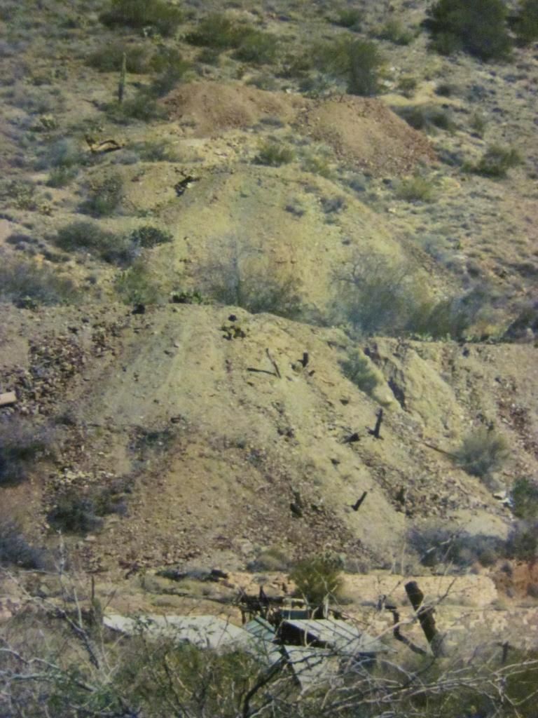

That is a HUGE pile of Gold that guy is sitting on. :)
Ha, ha! I can only wish. That's an old hardrock mine dump (lots of iron staining) he's resting on, and it's right near the very peak of the mountain. Those oldtimers weren't afraid to track the metals one bit. They truly went where the outcrops were--no matter how difficult it was to get to where they were.
Happily I made my trek on the quad, up and back!

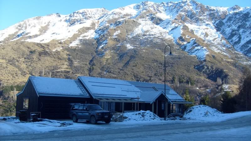

This is the view from where we are living at the moment
We are just coming out of winter so the ground will be more digger friendly.

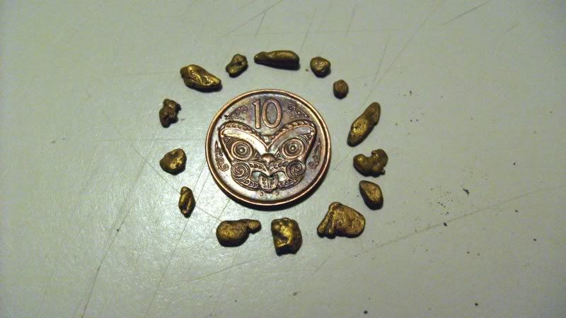

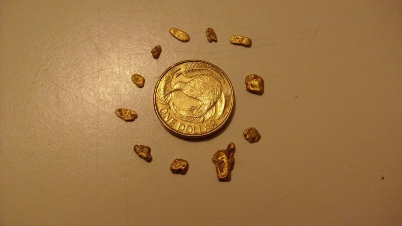

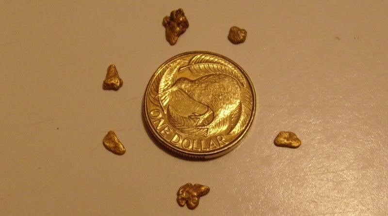

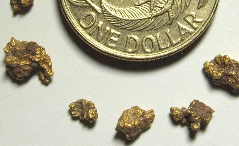

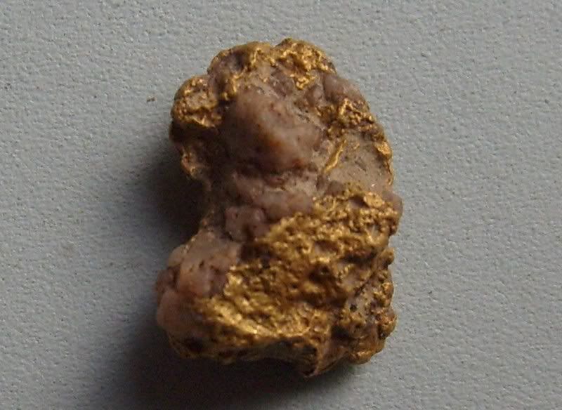

Not wanting to highjack your wonderfull thread here but here are a few pics of recent finds.
Last sunday
Each pic is different days finds mostly from the same area

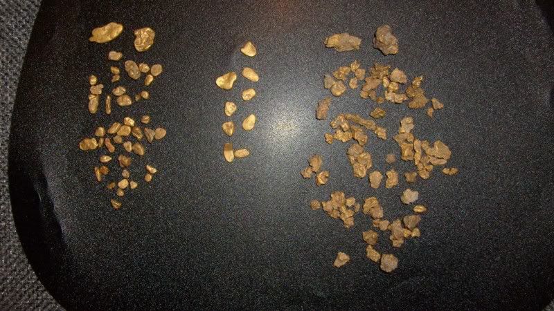

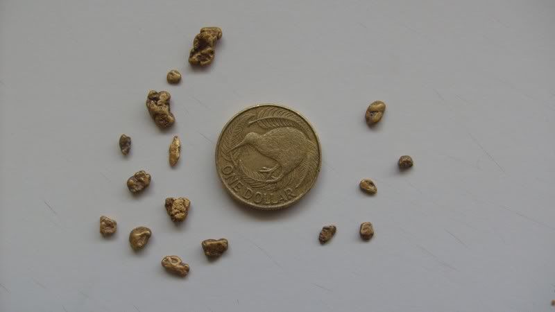

This is a group shot of gold from 3 different locations & isnt including any of the above finds.
The stuff on the right is very quartzy specimen gold & I am trying to locate the source. No luck as yet but good fun trying as I am still getting some great pieces in the search

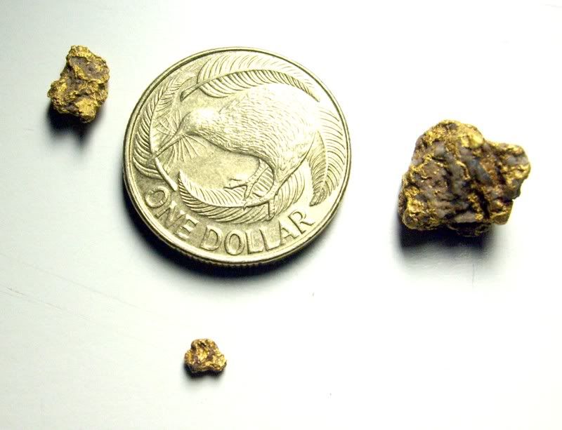

Here are some more recent finds in the continued search for the source
Close up of the bigger bit
close up of the bottom ones
The search goes on.

Wonderful shots of the gold, and thanks for the info. on the coils and how you're using them--you've given me some ideas.

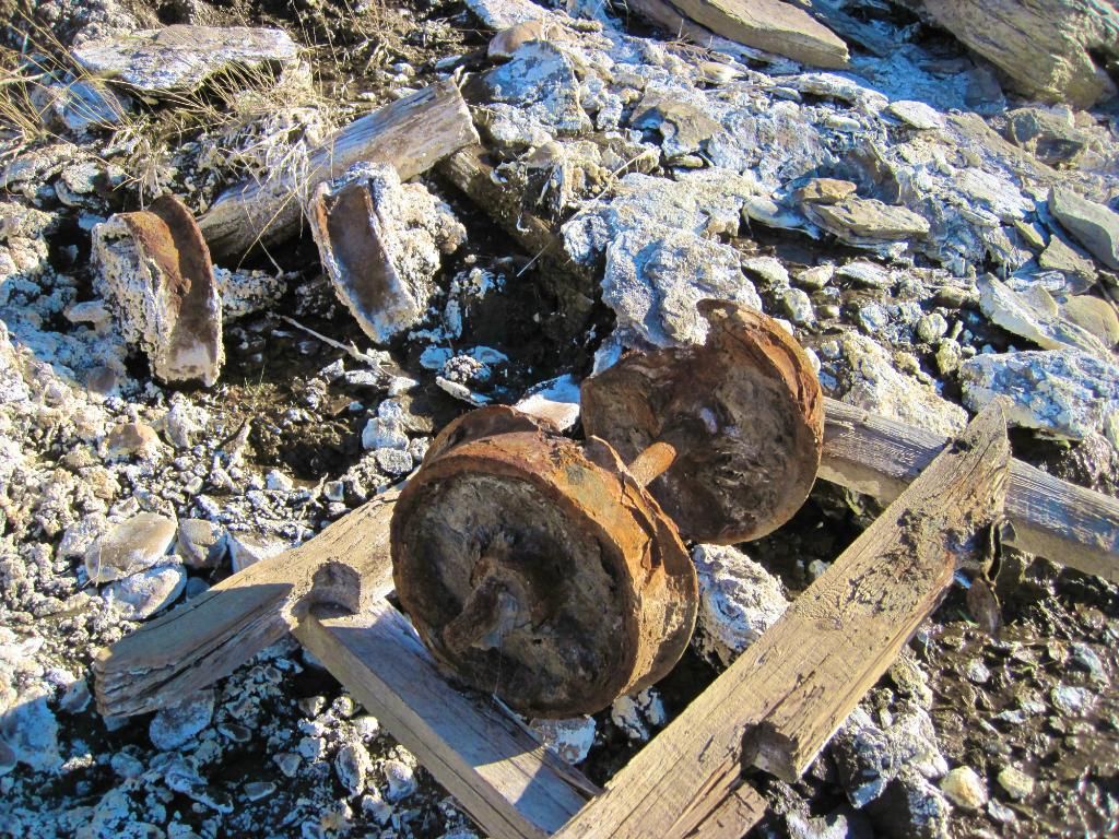

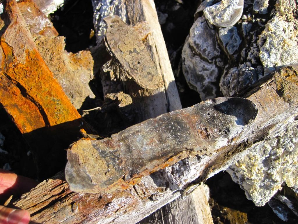

Not gold--but mining related. I stumbled across while out fishing on the weekend. It's an old coal mine that was uncovered as it was eroded from the riverbank by spring flooding. It's in a remote area only accessible by a very long walk.
The oldtimers in this area made leather slings that were secured over the thin metal bushings around the axles. I've never seen this before. As well, the rails were made of 2X4's. Mining was active in the area in the late 1800's and early 1900's. A friend of mine that owns the land told me that his grandfather had told him there was a mine on the property, but the grandfather never had the chance to show my friend where the mine was.
I've sent him pictures of the find, and I'll try to get back to take more shots of the site--my memory card was full! It's a long, hard walk to get back in there. The fishing was great though, most-likely because of the difficult walk. (The rainbows are in the 4-6 pound range--fat and sassy indeed! The very different colored fish is a Walleye, and he's a mighty fat big-boy too.)

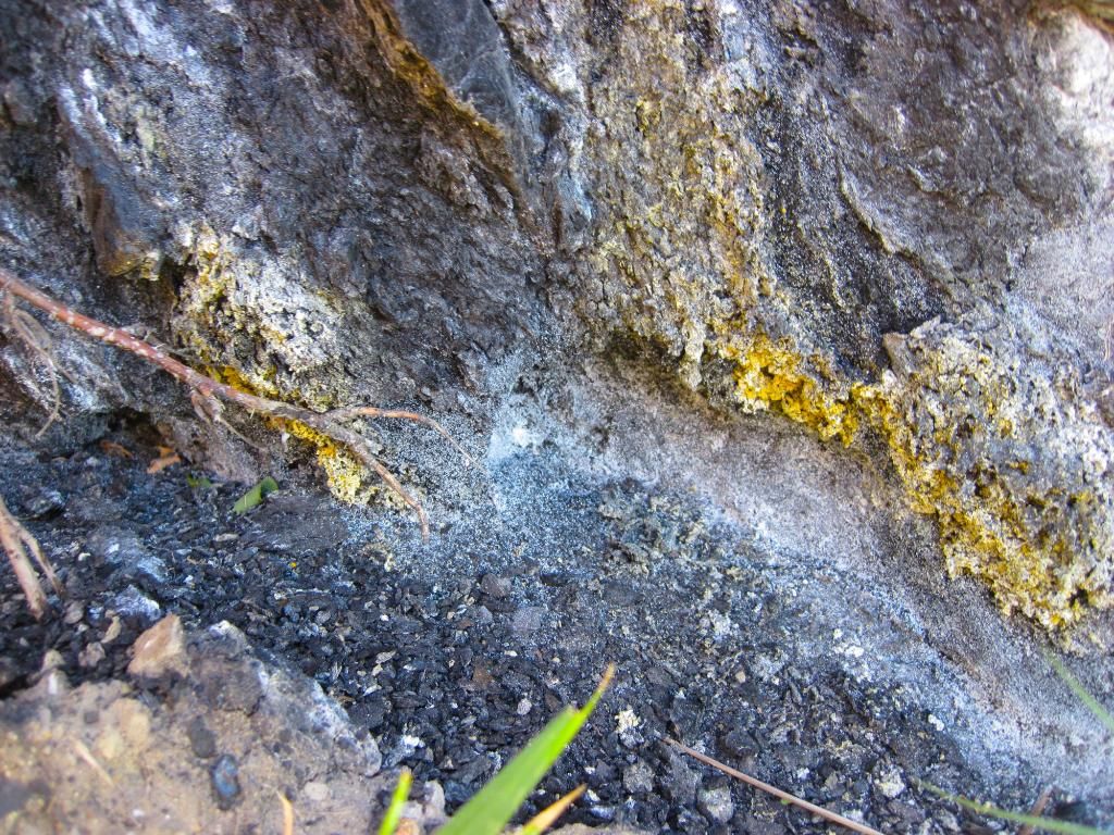

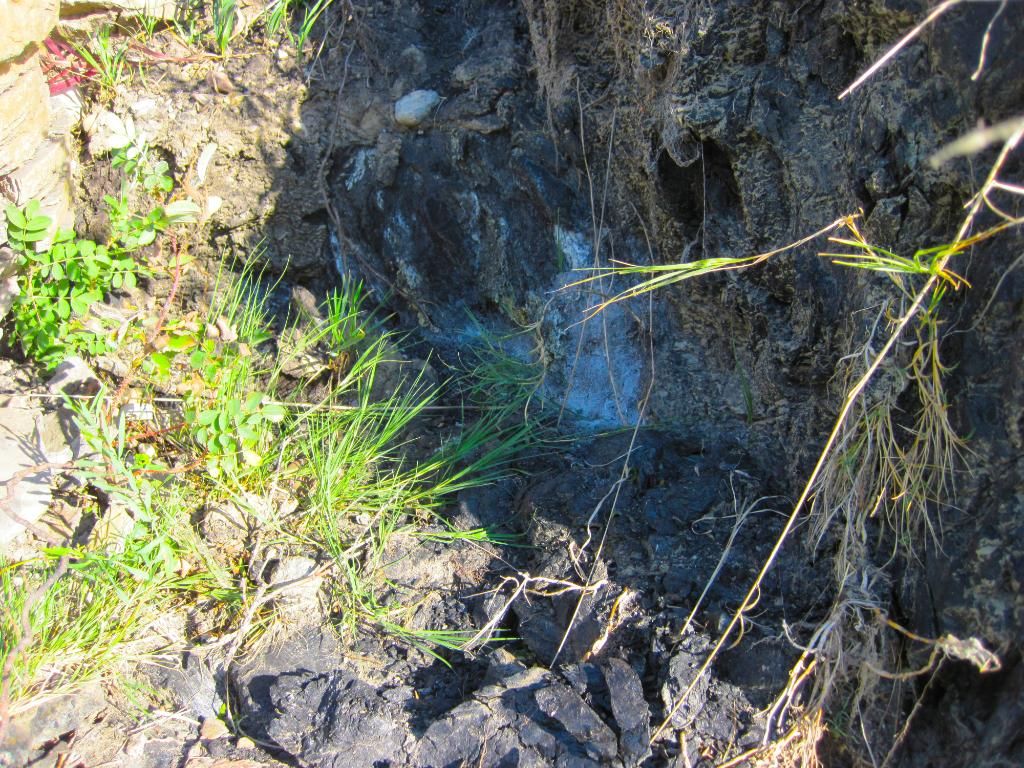

P.S. I did find a nice deposit of garnet and black sand that warrants further investigation. There is fine gold in the area and whenever there's a solid concentration of garnet and black sand, it's a hot spot. I often visually prospect for gold while I'm fishing, and it's lead me to some dandy spots over the years. Here's a tip I've offered before--fish and gold like to hang out in a lot of the same places in rivers--they both like to drop out of the current for a rest in low-pressure areas. Check those places carefully if you're in a gold-bearing stream.
(The gold-looking stuff is sulphur leaching from the coal seam. The white stuff is alkali salts--not snow.)

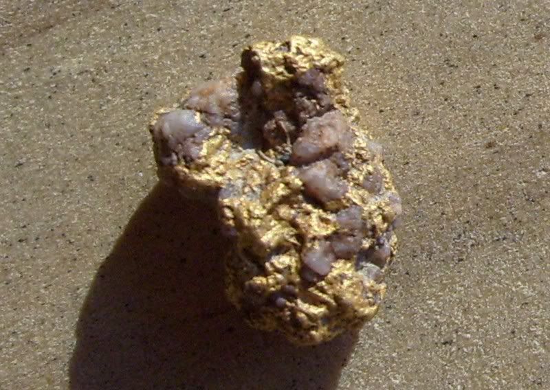

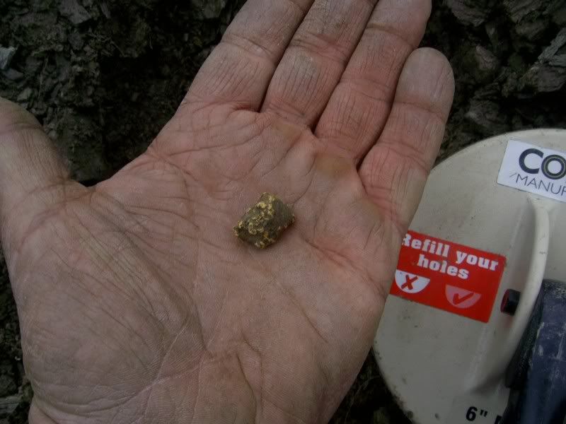

Hi there Dave Wiseman, Thank you for your comments & very good to hear from you. What are you up to these days. Are you getting out & into the hard rock gold??
Lanny, Thank you for your kind words. I forgot to mention those beautiful photos of yours. Stunning locations & very similar country to parts of Otago here in New Zealand.
Yes the 6" coiltek gold stalker mono is a deadly little coil. Good at finding bigger gold too.
9 Grams
Keep up the good work & all the very best out there searching for the elusive yellow my friend.

JW--holy jumpin' dynamite!
That is one meaty, sassy chunk of gold! What a gorgeous piece!!
And, you certainly had to dig through some nasty rock to retrieve it as well. Super find--nicely done indeed.

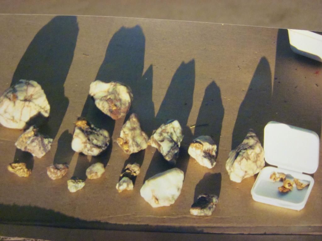

I made a couple of winter trips to Arizona to detect for gold. I met some incredible people while I was visiting my friends. My mining buddy that I've spent years chasing the gold with likes to winter in the mild climate of Arizona. He had a fine friend he introduced me to and we all went out in the desert to hunt some gold. To say my friends were successful is to seriously underplay their results. I'll let the pictures tell the story. I posted some of these on another thread, but I thought I'd like to keep them here so my pictures stay in one place.
If you've been there, that's Rich Hill over my shoulder.

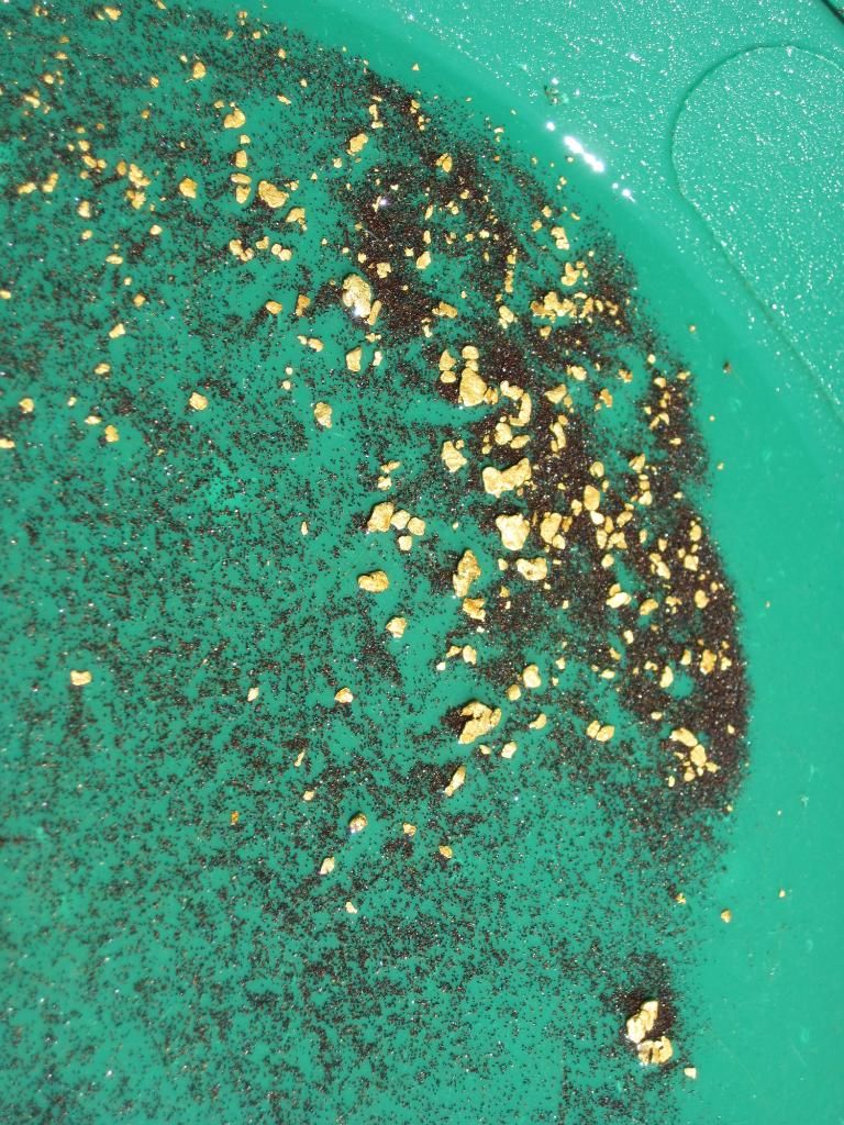

By the way--quite a bunch of these quartz and gold beauties take up all the space across the palm of your hand!
I'll have to write this story up one of these days--it's incredible how and where they found this gold, and they took me to the site with them, and then they found some more, even bigger pieces!!

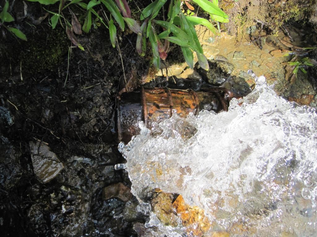

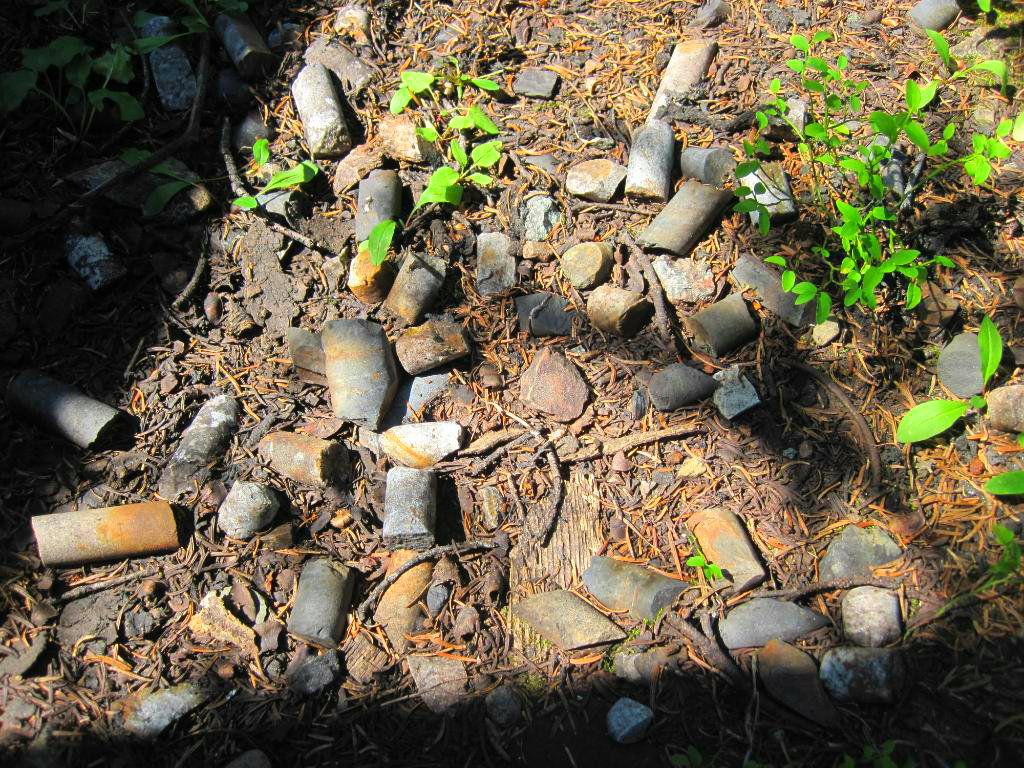

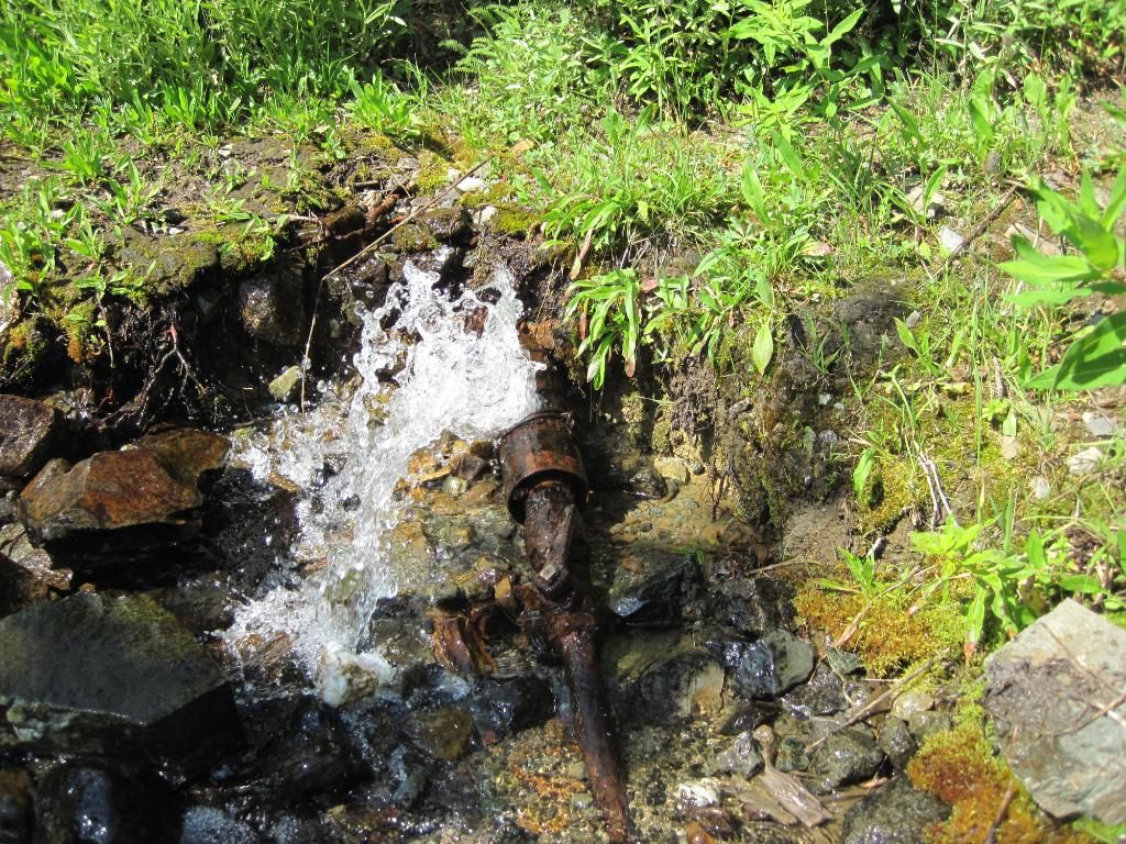

I found a bunch of old drill corings from a hard-rock mine (at an old camp they had) this summer--they're all over in the brush, but this pile showed up the best in a photograph.
This was pretty cool--the miners at the camp had harnessed a spring of water and had a valve to route the water to the various buildings so they had running water without having to ever pump it!
You can still see the little oak culvert wrapped in steel wire that connected to the valve.

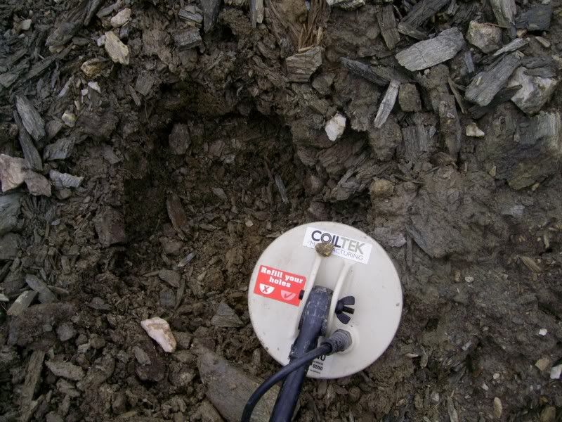

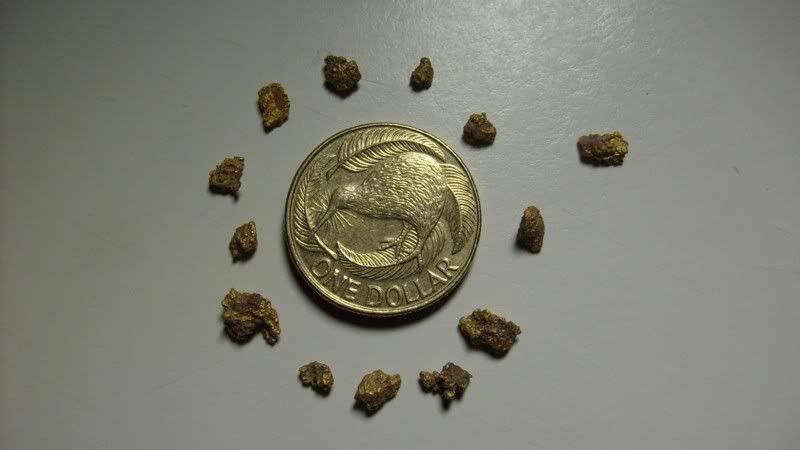

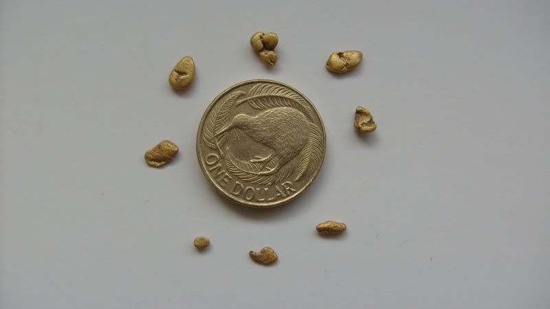

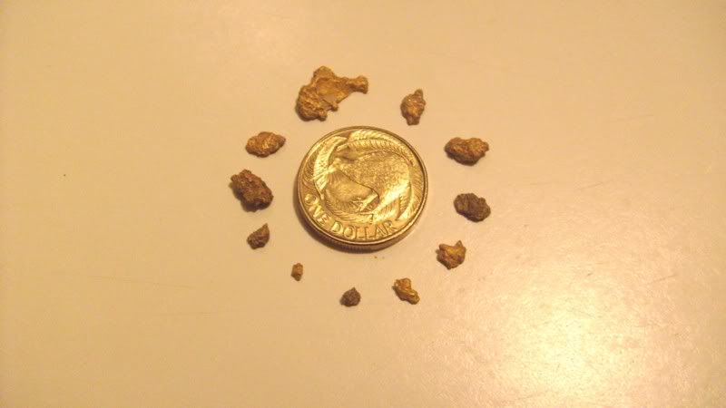

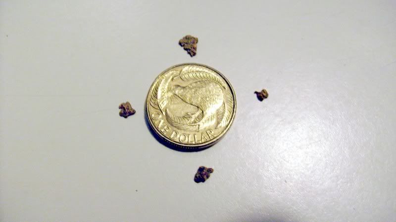

Bit Of Kiwi Bed Rock Gold
Hi Lanny & all, Great pics & adventures there Lanny. Thank you so much for the effort & time you put in to capturing them & putting them up for our benefit. Thank you also for the invite to post on your wonderful thread here. Most of my detecting is done on the bed rock that the old timers exposed with there workings. So not out of place here. Last weekend being no different.
Headed to some old sluiced workings & stumbled on to a bit of a patch. I had left on the minelab commander 11" mono that I havnt taken off for well over a month. It is giving me more depth on old workings that I have have combed over with my smaller mono's. joey 5 x 10, 6" coiltek, 8" commander & 12x7 NF. The depth & sensitivity of the 11" on the small gold has gobsmacked me.
These paticular workings I hadnt detected before. They were pretty over grown with briar rose & thyme bushes & I wasnt too sure how deep to bed rock schist. There were patches of exposed bed rock from the old time miners washing off the overburden & stacks of rocks that didnt appear to be very high sitting on bed rock.
I went over the workings with the 11" first for that extra bit of depth. There were quite a few places that I couldnt get the coil in to due to the bushes but was going to wack on the joey for these areas later.
Total gold for the 11" was 12 pieces for 6.9 grams. Biggest was 1.25 grams & the smallest was .06
I then put on the 10 x 5 joey mono to get in between the bushes & rocks where the 11" couldnt reach & snagged 11 more pieces for 3.95 grams Biggest 1.42 grams & smallest .05.
Then put on the 12 x 7 NF mono & went over the workings for the third time. This time only getting 4 pieces for .62 grams
All up 27 pieces for the GP 3000 for a total of 11.5 grams. I was pretty happy with that. Been my best haul for a while.

JW,
Great finds! I'll have to give my 11-inch Commander more of a go for sure. You're certainly discovering what's working and you're giving all of your coils a good workout--to great effect! Nicely done and sweet photos of some sassy NZ gold. Thanks for posting shots of your hard-earned golden wages.

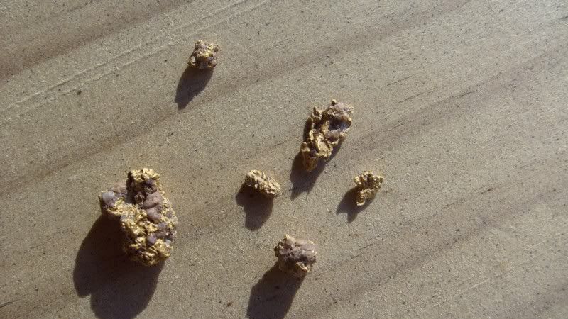

Here's a shot of some gold I dug--some sassy Western Canadian gold from north-central British Columbia. Those are big, old-school silver dollars the gold is posed on.
