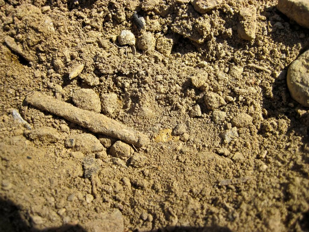

I never go prospecting without my MD-20.
The more I use that handy little thing--the more I like it! I also learn more uses for it each time I'm out. For instance, we were running dirt, and when I cleaned up, there was a heavy in the top of the pan that looked like pyrite (stained red as well), but did not act like pyrite at all. The Falcon sure ID'd it! It's nice and clean now, and it's easy to see that it's gold.
All the best,
Lanny

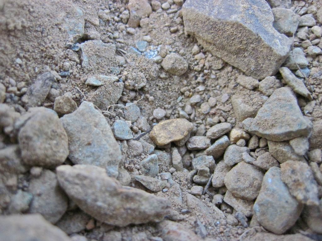

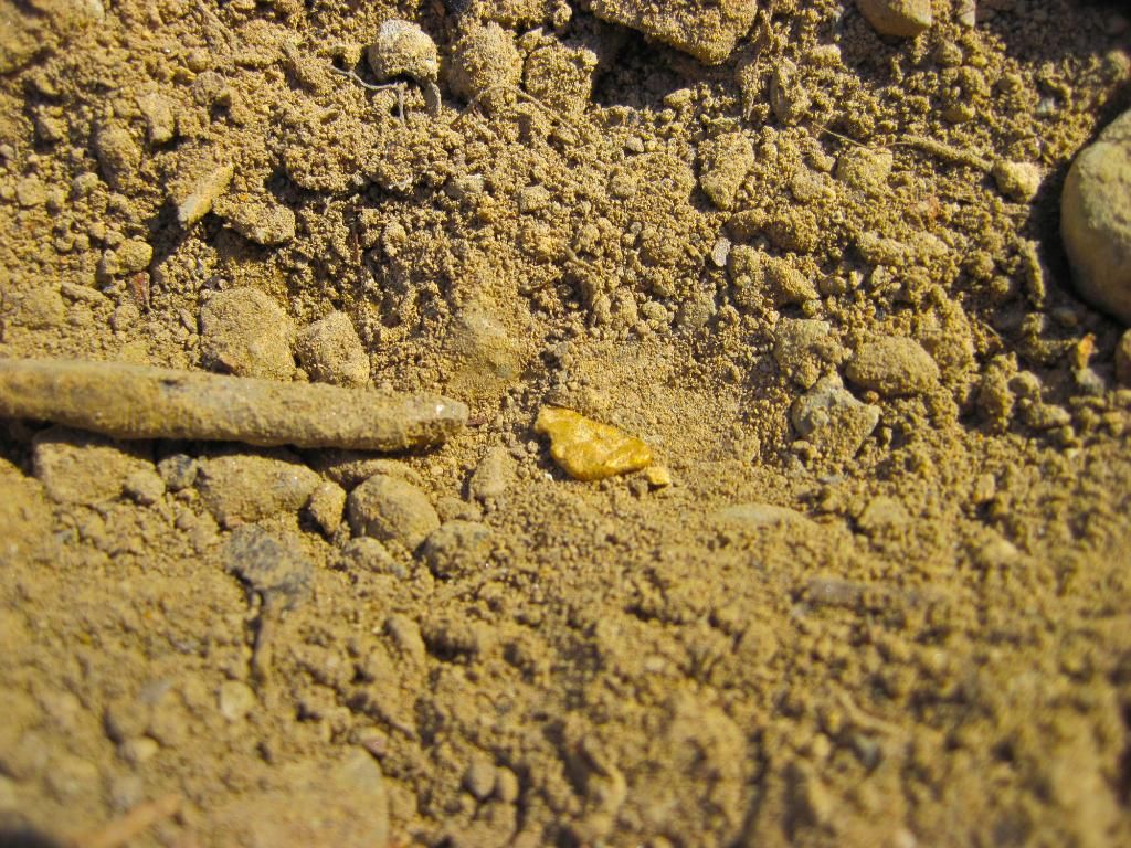

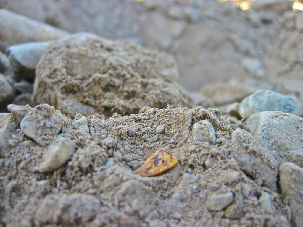

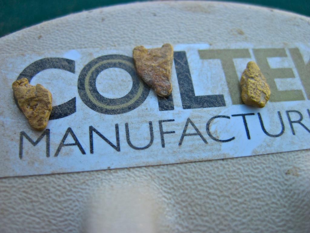

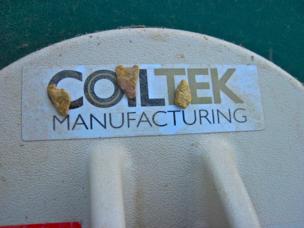

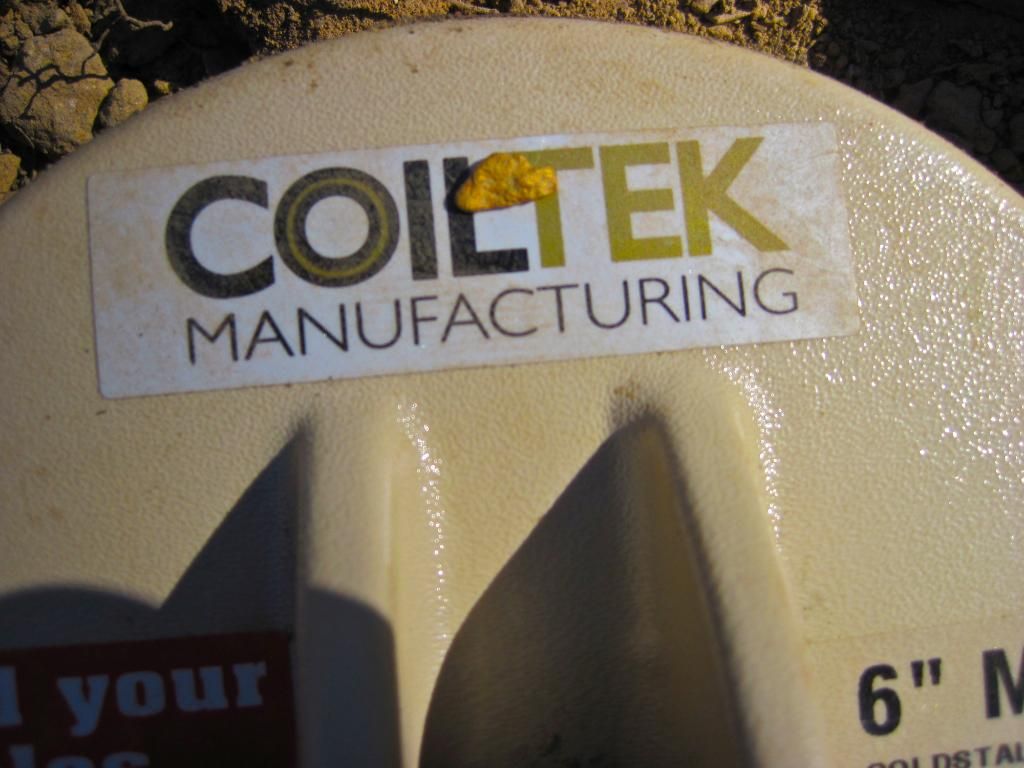

This was the first of the sassy little beauties--then came numbers two and three. Lots of fun--I broke out of my slump in this area big time.
All the best,
Lanny
Sassy nuggets to be sure!
All the best,
Lanny
