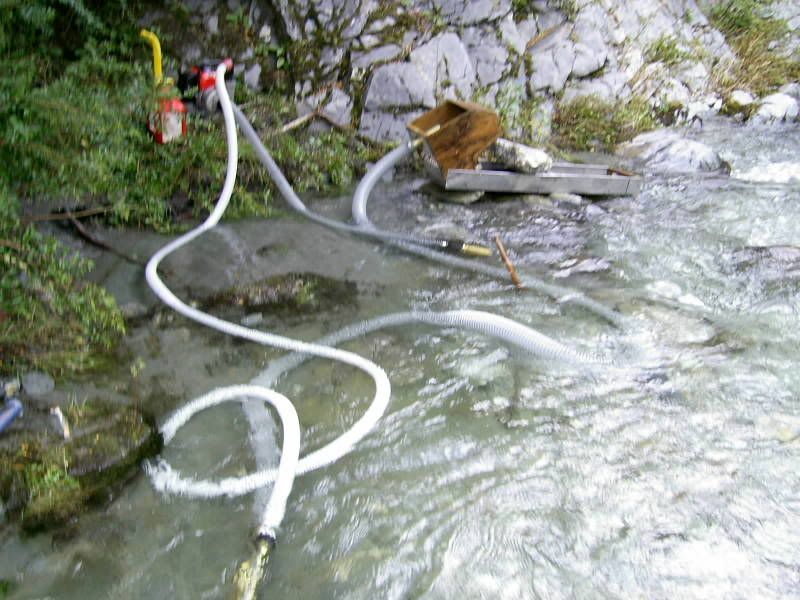

Hi Jim, Many thanks to you for your comments. A picture tells a thousand words..... You will notice in the pic of the bed rock how the little quartz stringers have been displaced on the fracture , crack, lines. It is a greywacky basement rock which is sedimentry in its make up but after is was laid has been effected by the volcanics & heat source that played a big part in the building of the Coromandel Peninsula & its geothermal & hydrothermal gold deposits. I guess this is where the quartz got deposited when in its heated liquid state through the cracks in the ground. There is also a lot of pyrites & some beautiful cluster samples as well as impregnated through the greywacky itself. Very little quartz float in the entire creek itself. Odd......& buggered if I can find any trace of the stringers that those rich little specimens have come from. This little creek was one of the very few in the Coromandel that was ground sluiced in the very early days for alluvial gold. More dentital gold than alluvial as they sluiced the shingle & talas material of the surrounding steep sided valley walls that plunge into this little creek & I would say at a guess they used the creek as a natural sluice box. Blowing all this material down & through the creek. Then cleaned up the bedrock to recover what they had washed down from the surrounding hill sides. What I am getting is stuff they missed in their clean up. Guess it is easier for me to get into the nooks & crannies with my suction gear. I have used my little 2" suction nozzle dredge here but it drained all the water pretty quickly plus it was noisey & there is a popular swimming hole in the main river that this creek flows into not far away. So wasnt too keen on running the motor & pump when people were there.
Here is a pic of my little 2" suction nozzle set up. You will notice that it is the same box I used as my sluice box in the above pic & also in that pic you will see the header box in the very top right hand corner sitting up on the bank.
Happy golding
JW :thumbsup: :coffee2:
