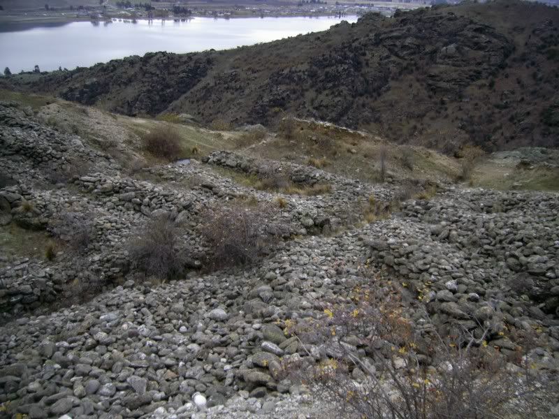

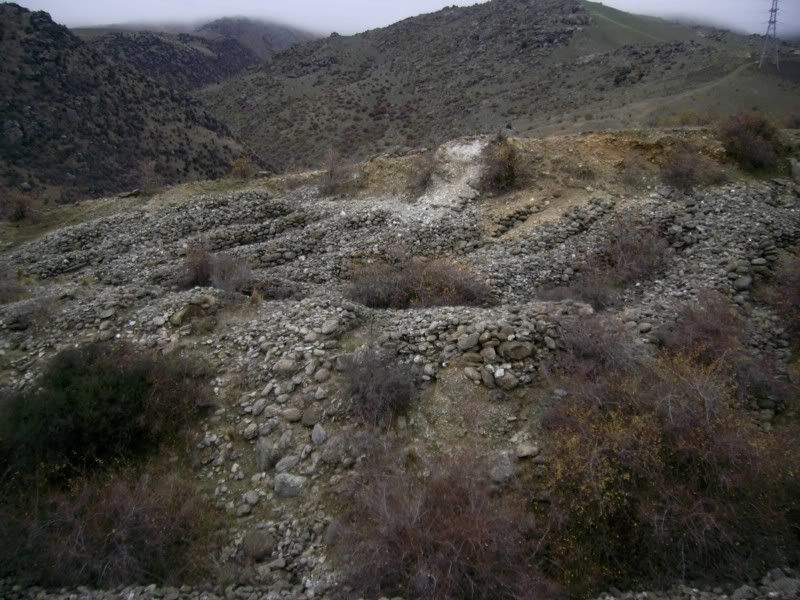

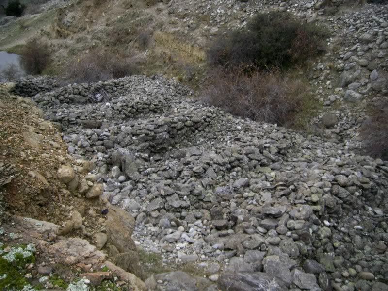

Hi there Eagledown, Hows this for some rows of stacked tailings.
All this ground has been worked & the rocks were stacked on worked out bedrock as Lanny has stated. But I am sure there are cases like you mention about stacks being on virgin ground but I think here in NZ that is unlikely. In New Zealand all old tailing piles have a heritage protection order on them & cant be disturbed.
Happy hunting
JW :thumbsup: :coffee2:

Holy Mackeral!!! And here I thought that only the Chinese were that industrious.
Isn't it amazing the lengths that man will go to, to gather a metal that isn't really all that rare?? :dontknow:
Thanks for the picts, they put a whole new meaning to the phrase; "Stacked Rocks". :laughing7: :laughing7:
