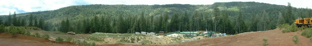

LOL.. Two entirely different setups and scale of operations. Reeds photo is from 20 plus years ago would be my guess. Again the man can't except technology. I bet he is still using dial up internet, P100 processor computer, pumping his shower water, waiting at a closed gas station with the sign out front for gas at 19 cents per gallon and wondering why there is nobody showing up to pump his gas.
I like my blue bowl I classify all my fines first with different mesh screens . Then I use a little dish soap to help break the surface tension of the water and spoon feed the bowl real slow . Keep on eye on the cone fine gold will walk up with the black sand . Sometimes I use a little mercury in the bowl to help catch micro gold . I save the mercury and When it turns to grey mud a little nitric acid and stay up wind to clean up . The gold it catches is so fine it won't break the surface tension of water when sprinkled on top . Think about it the next time you toss that black sand . Another note the mercury I use is what I saved from Dredging on the south fork of the American when it was legal .
LOL.. Two entirely different setups and scale of operations. Reeds photo is from 20 plus years ago would be my guest. Again the man can't except technology. I bet he is still using dial up internet, P100 processor computer, pumping his shower water, waiting at a closed gas station with the sign out front for gas at 19 cents per gallon and wondering why there is nobody showing up to pump his gas.
The pic is older because I shoot videos now & don't take pics anymore. That pic was from 2005 cause it was the best pic of the spiral wheel part of the plant. The wash plant was operating 2 years ago but I haven't been back this year to see if it's still running. Here's an update :occasion18:
Update on Liberty Hill Mine
