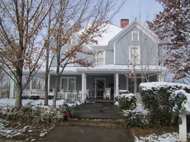

The first site I had planned on working is the local boarding house my family used to own (my 2nd cousin still owns it). My grandfather grew up there. It is right downtown next to the RR tracks and train depot. Probably built in the late 1800's. Travelers from all over the South would stay there while passing through or for extended periods of time. It was fully operational up until the mid 80's.
The yard is made up of Georgia red clay, and there are lines running across the street near the front of the house. This really has me bummed because I'm pretty confident this site is going to give up some coins...
