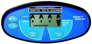

I started metal detecting with my Quicksilver pretty recently although I have had it a while. I have been using the standard 8" Coil and have been finding wheat pennies and newer coins, the oldest was 1944. I am not sure whether or not I am just not good at this, I am looking in the wrong place, I haven't been looking long enough or if I would be doing significantly better with a larger coil so I could detect deeper and possibly find older coins. So far I've detected at 3 different places built between 1890 and 1920 so I would expect to find some coins from that era but so far the oldest was just 1944.
Anyone else use a Quicksilver/ have experience with the 8" coils compared to 10"? How much deeper can the 10 inch coil go? Have you found more older coins with it?
The 8" coil should be fine for depth. 6" at least. It is more important to find an area that has not been detected so much. The Quicksilver lacks information on the screen (4 segments, and take out iron and you are left with 3), so it's basically a "dig every target" type detector. Without a pinpoint feature, and because the older units aren't as fast in recovery rate, is going to make it more difficult to zero in on where the target is. Even the cheapest newer units are a far jump to make detecting easier while having a superior recovery rate to know exactly where to dig (as well as improved depth even with an 8" coil). Before buying a 10" coil for an older model, your money would go further just adding a little more for an updated unit. Selling the older unit. and taking the money you'd spend on another coil should give you enough to make your detecting much easier and productive.
