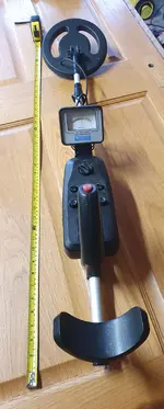

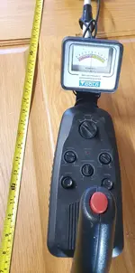

It is a while since you posted but I found your post while looking for the same information re. Normal/Basalt, VLF TR1 TR2 etc. . Thanks to everyone for their help. In return, I would like to add some information about the "Precision Gold" N19AC detector. I could not understand its many dials but eventually found that I had scanned and saved their user manual to a .pdf file on my computer. As the detector is no longer sold by Maplin (they went bust) other people may want the manual to the N19AC, so it is attached for all here, along with some pictures. It is probably a generic, rebranded, badge-engineered device, perhaps even the same as the "Famous Trails" 7030 mentioned above. 20221229_114354.jpg20221229_114559.jpg20221229_114508.jpg
