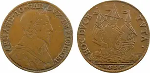

UPDATE: I know this isn't right, but the words looked like MANDIOC AR DUX ET ACHELL.
I did a search of these words even though I might have missed a letter here and there, and came up with Manuel du Voyageur en Allemagne.
Not sure if im getting hotter or colder.

With the new pics, it has the look of a Spanish Netherlands Jeton to me. Looking online now.
I think it may be this style jeton - might not be the exact same as this - there seem to be a number of varieties. But I think this is the guy..

Sure looks like that could be it.
Agreed looks like a Jetton with a sailing ship.

BINGO!! That sure looks like it to me. I was trying to make out the letters and all I could come up with was MANDIO AR DUX ET ACHELL.
That's pretty close to what is pictured on this Jetton.
Looking at my pictures im seeing a lot of vertical lines, so im not sure mine is pictured in the link you provided, but I do believe mine is a variation.
So what I think I can say at this point is it is a Cardinal Et Duc De Richelieu Probably 1630-1640's Jeton. "WOW" That's pretty old for my area..
The age is a guess considering all of the similar ones at the provided link are from this era.
