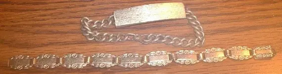

Now, I dig everything. Couple of weeks ago, found a Pope XIII Leo Silver medallion, big as a silver dollar, which is from the 1880?s according to Mark Parker, in a supposedly hunted out park!
