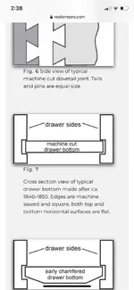

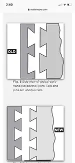

I have a feeling this is a remake throwback neo made in the 1960's of possibly German 1875-1918? style. 1920's-mid 1970's has a lot of neo remakes in many types of Art.
They are great resources! Thanks
See clearer of dovetail joints. Seems they would indicate machined qualities with pins and tails equally spaced. However it doesn’t seem they fit perfectly, with some kind of filler. Does this maybe indicate they are made by hand. Also the joints on the back of drawer bottom panel seem to narrow at the end—don’t know if this is fake or indicative of early 18th century age. I really still don’t know if repo or authentic. Waiting for someone to point at the smoking gun.
