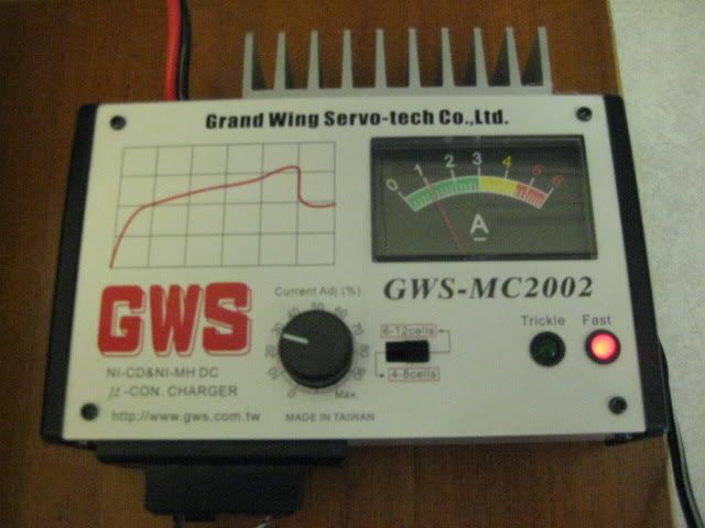

My problem was with the Excalibur ll and it's battery system. It takes like 17 hours to fully charge the battery on it. There is nothing to show that it is in fact charging or that it has finished and is charged. How many of you have gotten to the beach an turned your machine on to find out its DEAD !!!

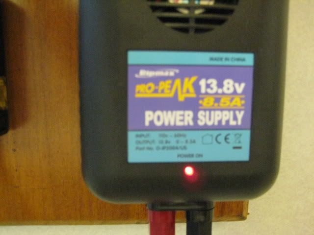

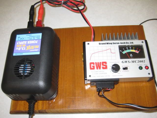

So here we go. I made this up after my hunting partner Pete (Erikk) showed me how to do it. I found a used one on ebay so that brought the price down on the GWS. The power supply I couldn't find so had to buy that new, but I am more than impressed.

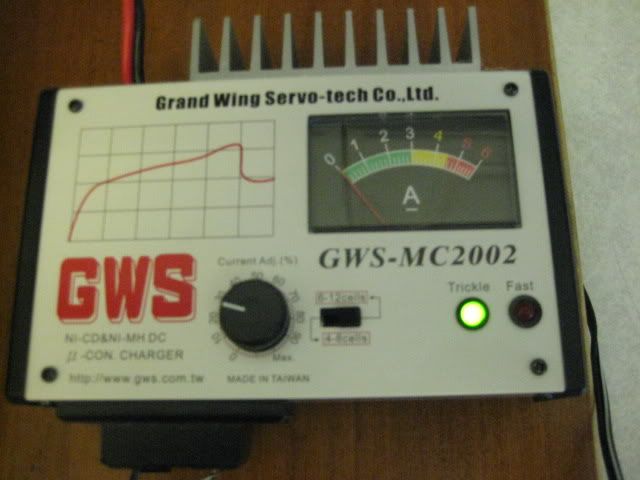

You plug it in set the needle to 1 can go higher but I found no need to and in 15 minutes (YES) it is fully charged, And what I like is a red light is on showing that it is charging and then a green light comes on when its done.
This can be used on other systems also. I am in the process of hooking it up so I can re charge my rechargeable AA batteries for my beachhunter300 , all you need is one of those radio shack $2.00 AA plastic holder and charge away.
So you could forget to charge your machine the night before and think ,I cant go hunting today, no fear plug it in for 15 minutes and you are on your way.
I mounted mine on a board and used some goop to fasten it but thats not necessary.
Hope this helps everyone.........

did you cut the wire off your factory charger so you could connect it to the new charger?
yes I did and its thin so I doubled it and then coated it with solder to make it stiff so its easier to put into the connection....

Your welcome I have also cut my setting in half use to set it at 1 now I go half of that and it still takes minutes to fully charge it. What I like doing is when the light turns green I un plug it then wait a few minutes plug it in again until it turns green a second time and you should be good to go
