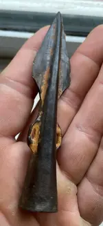

Awaiting a meet up with my local find liason officer to take thismid Bronze age spearhead i found last week to be analysed and recorded by the portable antiquities scheme (UK) I'm dying to get the crud off it and with just ketchup and a cloth with tepid water ive managed to remove a fair bit but it's stubborn and im reluctant to go at it any harder with such a magnificent + 3000 year old relic like this.
Anyone know any good non abrasive methods to remove dirt like this from a Bronze alloy?

Honestly, I would do nothing more, give it to them and let the experts do the cleaning.

Having been back to the area just today and having dug a bloody deep hole while I was there finding a horse shoe for my toil, the soil is very Sandy so assuming the crud is that, and after a few thousand years its turned into sandstone

I was hoping more for some other reccomendation, perhaps spmething even more effective than tormato ketchup and warm water. Ive cleaned plenty of silver but not so much bronze alloys.

Hey Pepper, thanks for mention me!
@Urien,
you can remove the encrustions with a small scalpel blade. Not the medical ones which are too large and vibrates if you scrape away encrustions! This vibration can cause damages to softer patina.
I use for coins, bronzes etc. 30° blades (not the typical 45° blades!) for cutter knives, insert in a designer knive . They are very stable and much easier to use than medical scalpel blades and you can also use more pressure when needet. Also much cheaper!
For Traces that can not be removed that way, you can use a silver brush or rotating fine wire brusches for a Dremel.
The bonze is stable and has no chlorides in it, so a simple cover with Renaissance Wax is all it needs.
