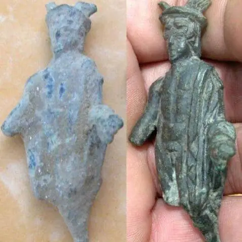

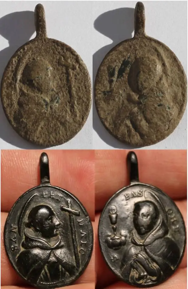

Some before and after pics:
14650169_1720504974939263_5175092166556601453_n.webp14713531_1720504971605930_5982850169595192370_n.webpamerica-1.webpIMG_3520.webpLarge Cent - Don.webp
