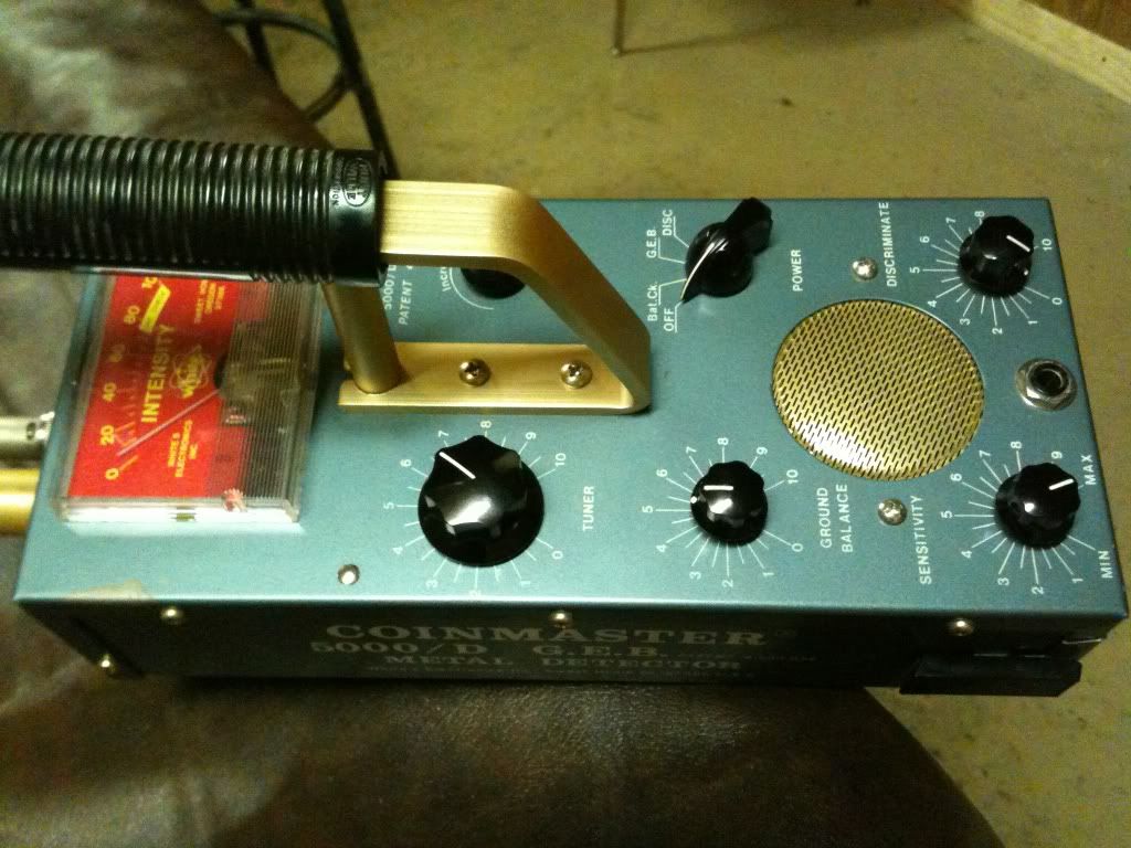

About 7 months ago my Garrett GTAX 550 was stolen. I havent been able to replace it yet. My grandmother brought me her old detector. Its a Whites Coinmaster 5000D and it appears to work. Was kept in a case and looks brand new.
I dont know anything about this machine, but I think after reading the manual I have it ground balanced right and have beeen able to find pulltabs and Iron in GEB (all metal) mode. My problem, is that when i run in discriminate mode, I have to turn up the descriminate control almost all the way before it will cut out a pull tab laying on the ground. Does this sound right, or is something not working right?
Also, can anyone tell me what kind of depth I can expect out of this machine?

Question for you: Is your 5000 a "series I" or a "series II"? If it's a series II, then that was actually a good machine for its time/era. But you say "32 yrs. old", so I suspect yours is a series I. If so, it's a dinasour by all means. A VLF/TR. And not a very good one, as there were competitor's of that era/day that outdid Whites VLF/TR's at the time.
As for the dial benchmark for where tabs are nixed out on the ascending/descending scale, it's going to depend on the calibration of the machine, and the size/thickness of the pulltab. Yes some ascending/descending scales had it so that the entire 1/2 of the TID #'s/coordinates, read only in the final 1/4 of the dial. So for example: if a tab reads 45-ish, you would *think* that would be "half way on a dial that represents 0 to 90-ish, right? But it just depended on how the machine was calibrated. You simply memorize the various points on the dial, for where certain items fall out at, on your particular machine.

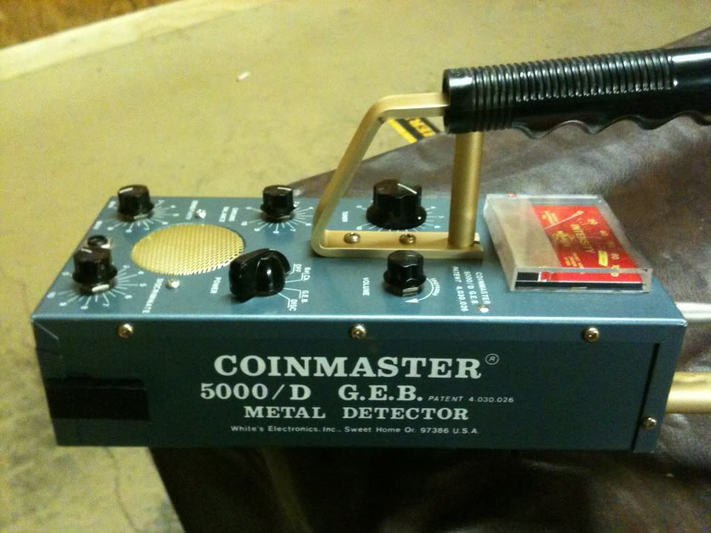

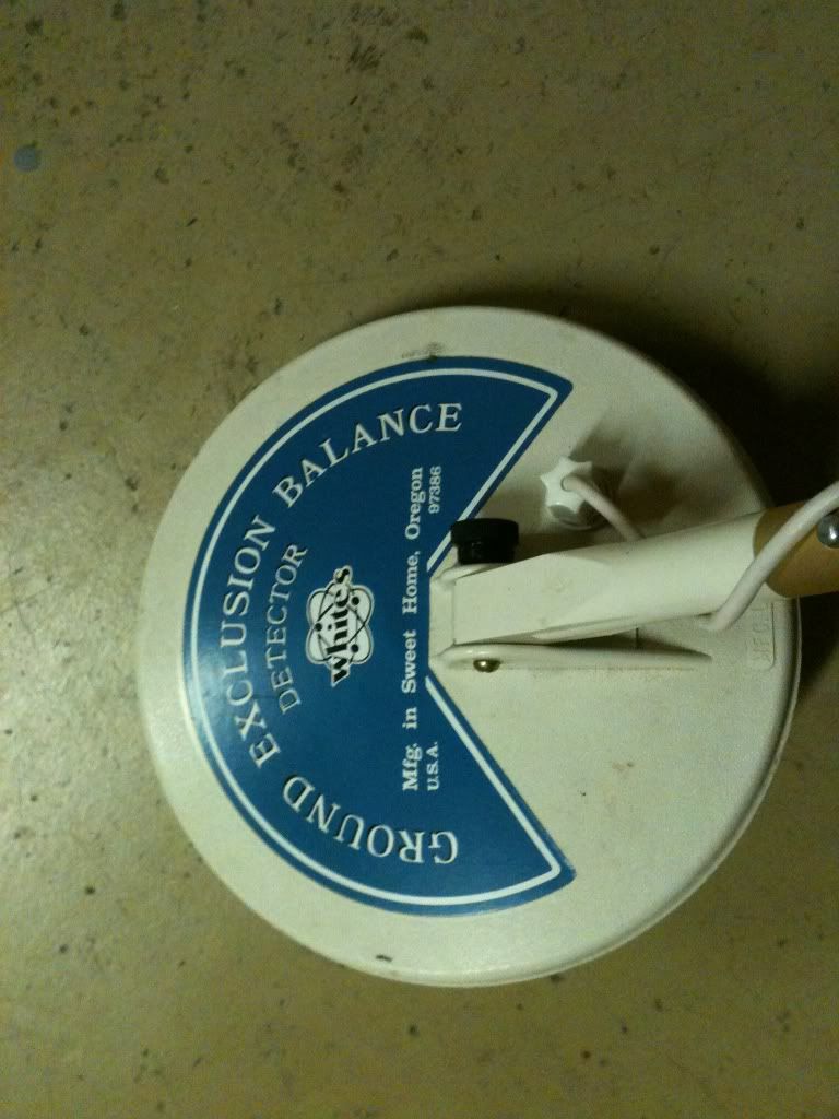

Here are a few pictures of the machine. The paperwork with it was dated 78 or 79.
Yes that's a series I. The Series II (which came out in about '82 I think) would have said "series II" on the box. Whites was selling less and less of the 5000d's by that time, as the newer-fangled motion machines (6000 & 6db) were much more popular, deeper seeking, etc....

My first tip for ya......ignore the meter...it really doesn't tell you squat. It helps to pinpoint a target and that's about it. Use your ears and learn what the different sounds are for different finds. Dig everything until you know with a high percentage of certainty what the crackles, beeps and whispers are.
Second....ground balancing that machine is critical in the performance of it. If it's not balanced good, your finds will all be shallow and different targets will all sound similar.
I see in your pic the sensitivity dial is set to max. Crank that baby to about the halfway point or less. Slowly turn it up as you go until you start hearing your threshold tone become eradicate, then back it off a bit from there. You want that threshold set at barely audible and steady.
I can't emphasize enough the importance of ground balancing your machine. It'll make a world of difference in your finds and your ability to discriminate.
Maybe try your machine in the GEB (ground exclusion Balance) mode for a bit. Figure out your soil mineralization.
I learned on the 3000 which was a bear to keep balanced but I ran it for a couple years and found silver with it til I was able to afford the 6000Di Pro, which is an awesome machine.
The 6000 series 2 is simply a step up from your machine, the intensity meter is a graded scale for depth but the knobs are almost identical and manual ground balancing is a must.

Thanks for the help. I don't seem to have any problems ground balancing so far, and Ill try turning the sensitivity down in all metal mode. Instructions stated maximum sensitivity gor all metal and 5 or half for disc so thats what I was going by.
