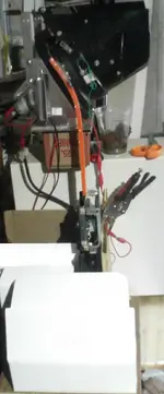

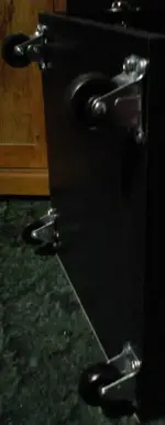

I finally found a finished cabinet worthy of using, though it's a bit large for a simple one analyzer application. It's 15.9"W X 16.6"D X 35.5"T. Available on clearance at the local Home Depot for $49. Inside width is 14.5", inside depth is 15.5", and inside height is 34". I will supply more info and pics after I get the mounting details ironed out better. So far, this is the plan...
I've settled on an upper shelf to hold the hopper in such a manner that the factory slide base will be used to retain it. This will allow the hopper to be installed and removed quickly for service or denomination changes. Each denomination hopper will have the coin output chute shaped so that it lines up with a different coin chute opening in the shelf below. Changing denominations will be as simple as sliding out one hopper and sliding in another. This way I only have to build one unit for all denominations I will want to run.
The shelf is already bolted in securely with four 2.5" L brackets. I used eight 3/16" X 3/4" aluminum binding posts to make nearly flush mounts through the sides, but regular #10 bolts can be used if you don't mind them being visible on the sides. I through-drilled four of the existing 3/16" shelf pin holes to get it mounted using the upper L bracket holes, then drilled four more holes through the lower L bracket holes for added strength.
I'll cut a hole in the cabinet top and use a large pet water bowl with the bottom removed to line the hole on top. This gives me a large coin feed hole that I can reach into for clearing jams or removing coins, ect.
There's plenty of room in the cabinet below for the coin analyzer units. I plan to mount the penny and dime analyzer units on the left wall, and the quarter and half dollar analyzer units on the right wall. The coin bins will go in the bottom, maybe under another shelf.
I could have fit 2 hoppers in a 24"W cabinet, but it would have been much more bulky to transport if I wanted to take it with me on trips. I removed the adjustable feet from the bottom and added 2" wheels to all four bottom corners to make it easier to move around.
Bob

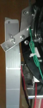

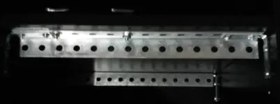

More pics, added mounting rails for the coin hopper so I took more detailed photos of the hopper portion.
Bob

Thank you, I'm trying to be helpful.
It's ok, you're not butting in. The purpose of this thread is to help others understand this homebrew sorter design and be able to duplicate it. By the wording of your post, you had mentioned the source of economical dime or penney hoppers, then added that eBay seemed to be cleaned out. I read that as them being out of the hoppers themselves, not the dime shelf wheel. I was totally unaware that the seller had sold out of the dime shelf wheels. Thank you for letting me know, I'll edit the post above to reflect that. I guess I sent him too many customers, maybe that's why he went on vacation :laughing7:.
There were other sellers on FeePay (eBay) that had the dime shelf wheels for IGT upright hoppers, they were just more expensive. Try searching for coin hopper wheel or coin wheel, most sellers use the wrong name. If you have no luck, let me know and next time I go to town I'll do some searching. From dialup internet here at home the high bandwidth site pages like FeePay just time out instead of loading. I can't even log in there from home.
If there are no more sellers offering dime wheels, and there is a demand for them, I have a machinist friend in FL that can probably make some out of 16 guage. I have a spare that I could send to him as a master to duplicate.
I added some pics of the cabinet and hopper installation while I was in town earlier.
Bob

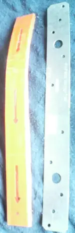

I like the coin chutes made from Hot Wheels track sections, easy to make and use.
The coin analyzer mounts that I use came with the 5 coin analyzer batch that I bought from FeePay. They work great for the application because they have the coin output pathways divided. It's pretty much made of galvanized sheetmetal that has been stamped in the shape of an open faced box. One could be fabricated by bending a single sheet of aluminum, or a pair of thin galvanized strips to engage the four mounting points on the coin analyzer. The snap-in mounting clips are sold on FeePay if you don't want to just use the four mounting screw holes.

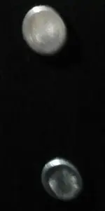

How about dimes? Here are some i got in 2009 at a yard sale.
Two are real.
