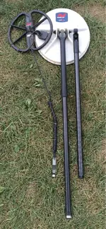

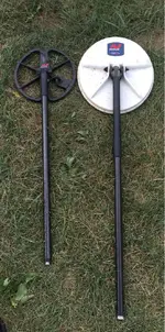

I kinda think it's my fault however. For me the lower shaft is just a little too short, so I find myself putting a lot of force rotating the shaft at the end of its extension trying to get a little more length(stop laughing, it's not funny) That's right where the clamp stop puts pressure on the shaft to keep it tight. I might look into getting the lower shaft from the new GPZ 7000 as I'm told it's longer. I'll have to check it out.
I know this is obvious, but if its under warranty Minelab will fix that up.... if the wear is on the lower shaft, not much can be done beside replace the shaft. However I'd think that the camlock could be replaced and fix up your issue.
As for the GPZ shaft.... it is quite a bit longer but I'd think there are two issues. One is the coil wire is probably not long enough to reach to use it on the CTX. Secondly the connection of the shaft at the bottom is signifigantly different so it may not bolt to the coil? I will have to compare them and see if its possible...
Yes please let me know. I appreciate it.
Ok, here are a few pictures. You can see how much longer the GPZ rod is as compared to the rod for the CTX 3030 and also how much different the end is on the GPZ as compared to the CTX where the coil bolts up. It would be a tough fit... I suppose you could make the coil bolt up but the cord would require a lot of stretching... Not so sure that would be a good idea with a several hundred dollar coil. :) ImageUploadedByTreasureNet.com1439049665.131829.webpImageUploadedByTreasureNet.com1439049675.380755.webpImageUploadedByTreasureNet.com1439049685.301984.webp
Hey Keith man thanks for that. I appreciate the time you took to check. Yea I don't think I would want to stretch the coil that much either. I'll see how bad it gets and maybe just send it in. Thanks again, Mike
