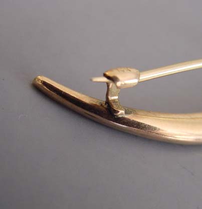

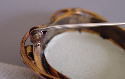

Here are pics of the catch. It has a hole in it for the pin. It appears to be a "C" catch with solid sides.
And that is the "catch" not the pin mechanism?
I believe so. I thought the same thing until I saw the hole in the catch. To be honest, it could be either at this point. Here is a photo of the opposite end.
You are right. I did a little more cleaning and the end that has a raised piece and the hold in the end also has two small holes, one on each side of the wingwalls.

I think it's a riveted hinge with either a c catch or a lever catch and probably dates to the turn of the century to around 1920. Still hard to decipher in a photo though.
Riveted hinge circa 1900...
Lever catch circa 1900...
And a C catch circa late 1800's....

Thanks CannonballGuy. The hinge looks close to the hinge and pin under the 1920s label. However the C clasp base doesn't look like the base that remains on my brooch. I should add that this brooch was found about 10' from a 1924 standing liberty quarter.
Thanks Diggummup. I appreciate the info. This helps. Mike
