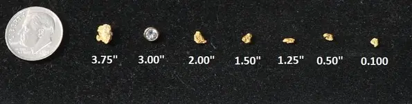

My HF coil test on small gold yesterday, I was impressed.
