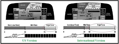

Both versions put out the same power.....the rumor that the International version has a higher output because of deregulation is simply not true. All Garrett did was open up the High tone to go lower in the conductivity range because of the types of old coins found in the UK. And of course one is in inches and one was in centimeters. Can you imagine the problems any metal detector manufacturers would have if in fact they did produce one machine with substantial more power over another simply based on geographical locations? The black market would be extremely busy.

Thanks John. I knew a difference in power didn't sound right.
Great Post John. When you see the screens side by side like you show it makes more sense to many people. :thumbsup:

The Pro and International are identical. The only thing that has changed is the lipstick and mascara.
If you look at the instrument panel (as John has kindly illustrated with a photo above) it has only been changed for non US markets. It's just a marketing ploy.

It would kinda suck if they didn't change the graphic for International users to match their coins and metric system wouldn't it? I sure wouldn't want to use one in the states, I have a hard enough time finding places to detect.
