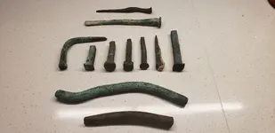

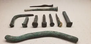

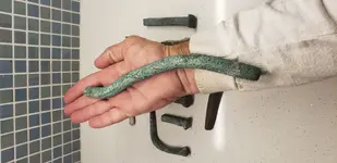

The more I read about the age and dates for different types of ships spikes the more I get confused. Here are some different types I've found over the years. All of them are different. I think part of the confusion is in the definition of spike, nail, and pin. The long one im holding is a pin....the rest are spikes. Ive left out the smaller nails for now. So I've come to the conclusion that no 2 sources are in much agreement about the time periods of use. I know one of these spikes is a cast bronze piece with a seam....i was under the impression that a cast piece would be of a later time period than earlier....now I have others that say it could be very early. I do have a record of where they all were found....and it might be nice to know just how old these pieces are !! So what do you guys know about ships spikes ?
I didn't know you were that good with spikes ARC. Well let's see if anyone agrees with your assessment. I was thinking that the middle spike in the second row was the oldest....possibly 16th century galleon.....back when spain was still building with bronze. The second one down from top I think your right about because it was out in front of preachers cave in eluthera....1680s-early 1700s....i think ?
Still that document makes me believe that any number of mixed fasteners could be used on a single ship with multiple styles being represented. That big pin in my hand is a blind fastener for sure in my opinion....so not 100% sure its as late as 1900s.....its definitely not a bolt.

I still say... IMO... your top 2 are the oldest.
Lets see if others will chime in shall we. :)

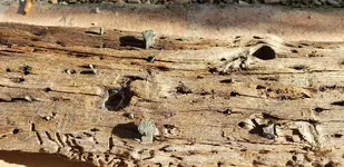

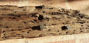

Here we see 3 types of fasteners at once. Spikes,nails, and holes from trennels. But I still can't date this timber.....i have nothing but the fasteners....just a timber that was up in the mangroves and mud.
you could be very right ARC...im kinda at a loss with random finds like these.....would sure help me make a decision on which spot I should be looking around at.....and if I had 1500s era spikes coming up....well let's just say I'd love to spend more time and effort at those older sites !!

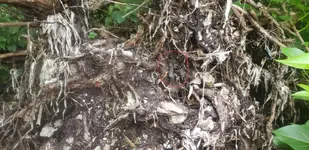

They pop up here and there on land too....last one came out of this rootball !!
