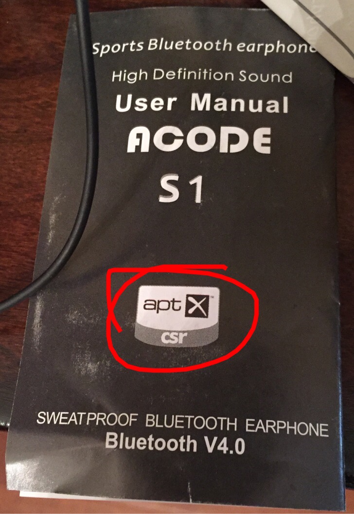

In contrast, here is what was actually received:
So clearly it's a mismatch between advertisement and product. Argh.
