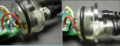

Does anyone know what connector type is used in the 8" water coil for SandSharks?
Here's a picture. I have tried to repair it but it's pretty fussy and I really just need a new connector. Any ideas?

I've tried, no-one recognizes it as it's not a standard 2-pin aviation connector. The orientation groove is in the wrong position relative to the holes. It seems SandSharks have had hardwired coils for a while now, as the original manufacturer of the connectors stopped making them. I have no idea why Tesoro chose those connectors rather than something standard.
I received another large connector casing today which I stripped, and I whittled down the plastic Tesoro plug with a knife to fit inside the casing. After some very fiddly soldering and shrink tubing, I then epoxied it all in place. I'll apply some more epoxy tomorrow on the outside to get a better seal and protect the casing a bit, and post a photo.
It's an M16 connector (the '16' means 16mm) made by Methode. Methode quit making them which is why Tesoro went to hard-wired coils. Other companies make M16 connectors and even though M-series connectors (M16, M12, M8, etc) are supposed to be standardized there are often design tweaks that make them incompatible.
Addendum: The Methode M16 is one of the best waterproof connectors I've ever seen. I've tried for years to match its quality but no luck.
Thanks very much for this info; well now I know the name of what I can't find.
Anyway, here's my attempted repair job. I hope it holds up.
