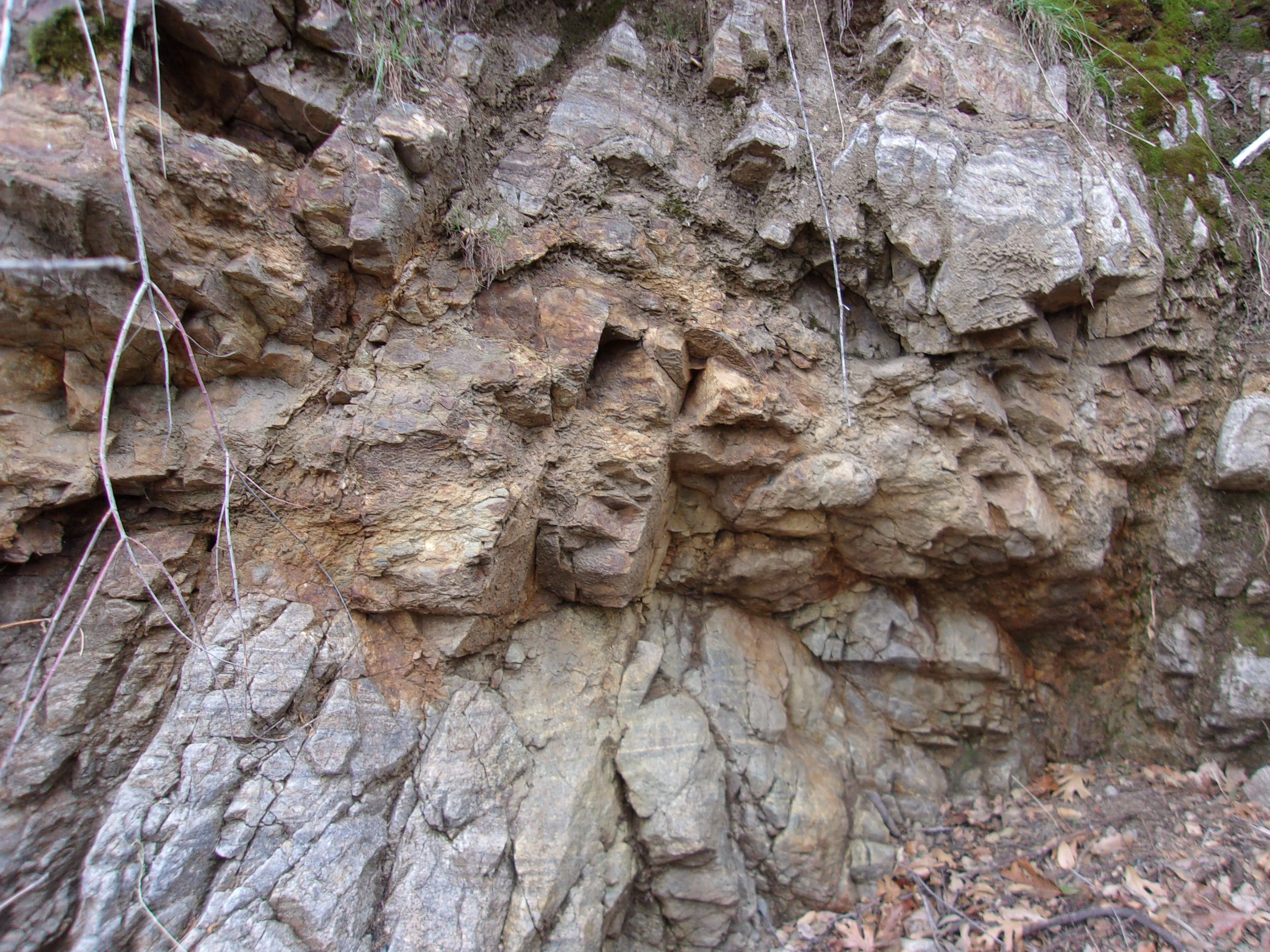

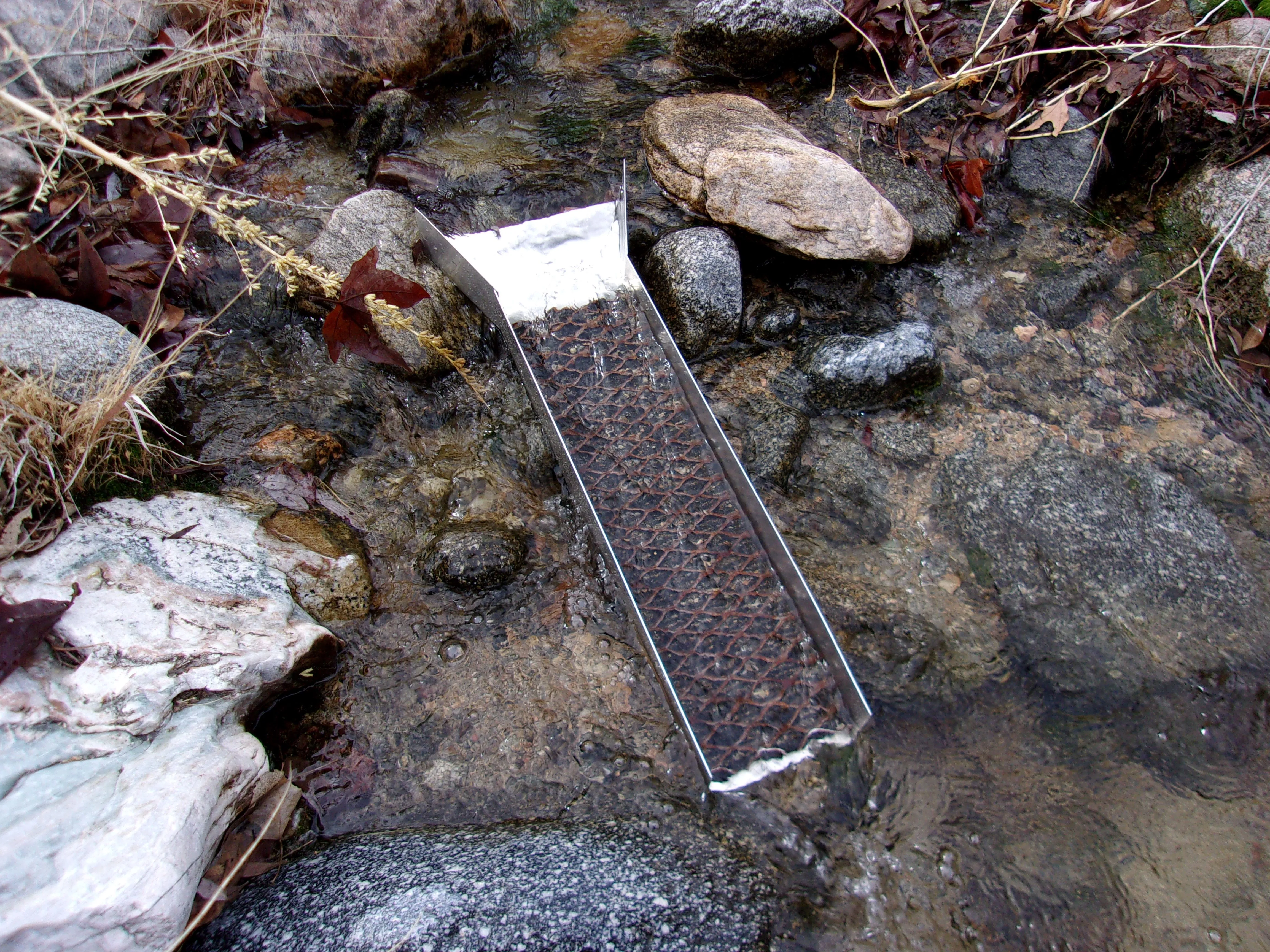

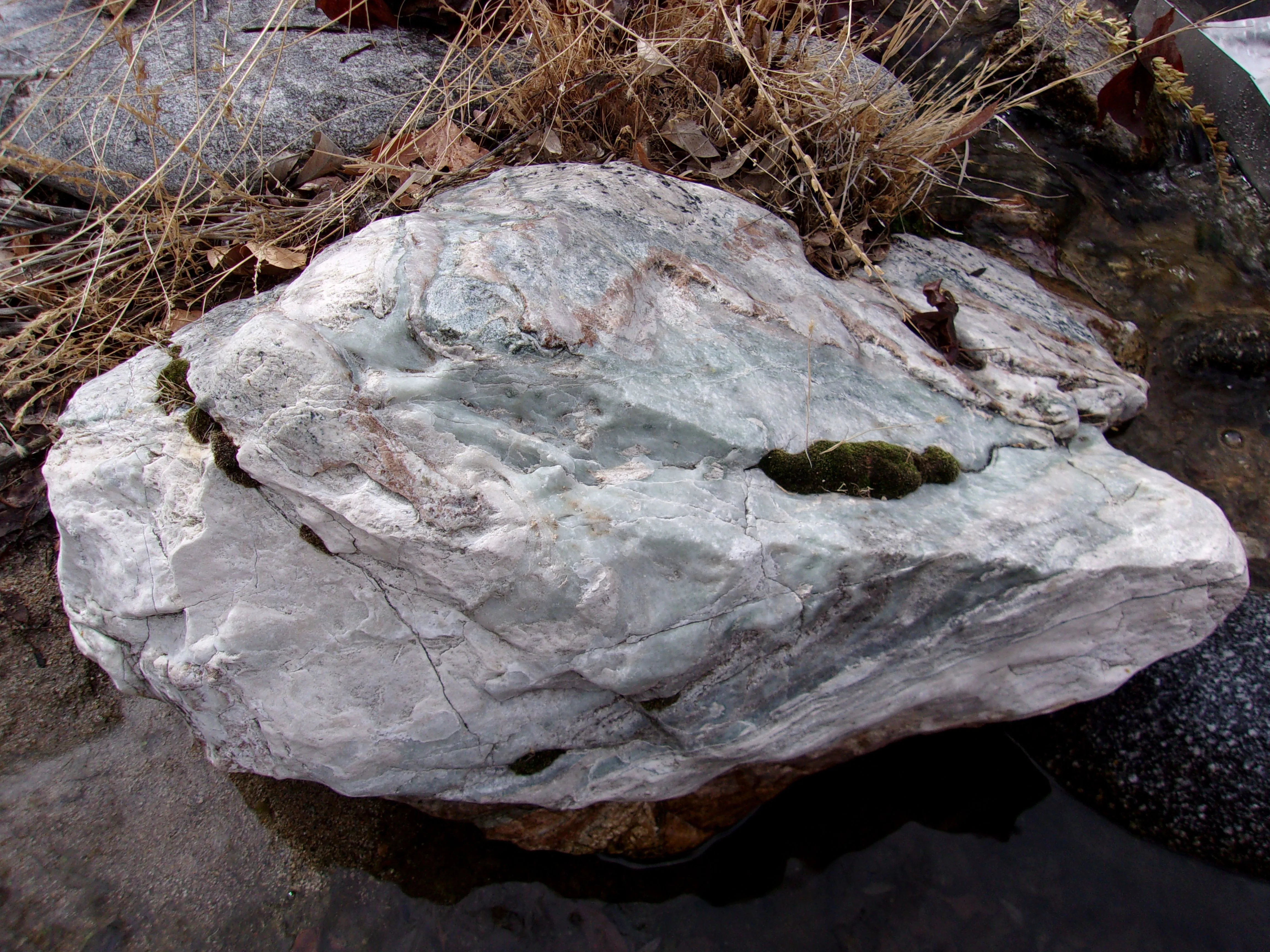

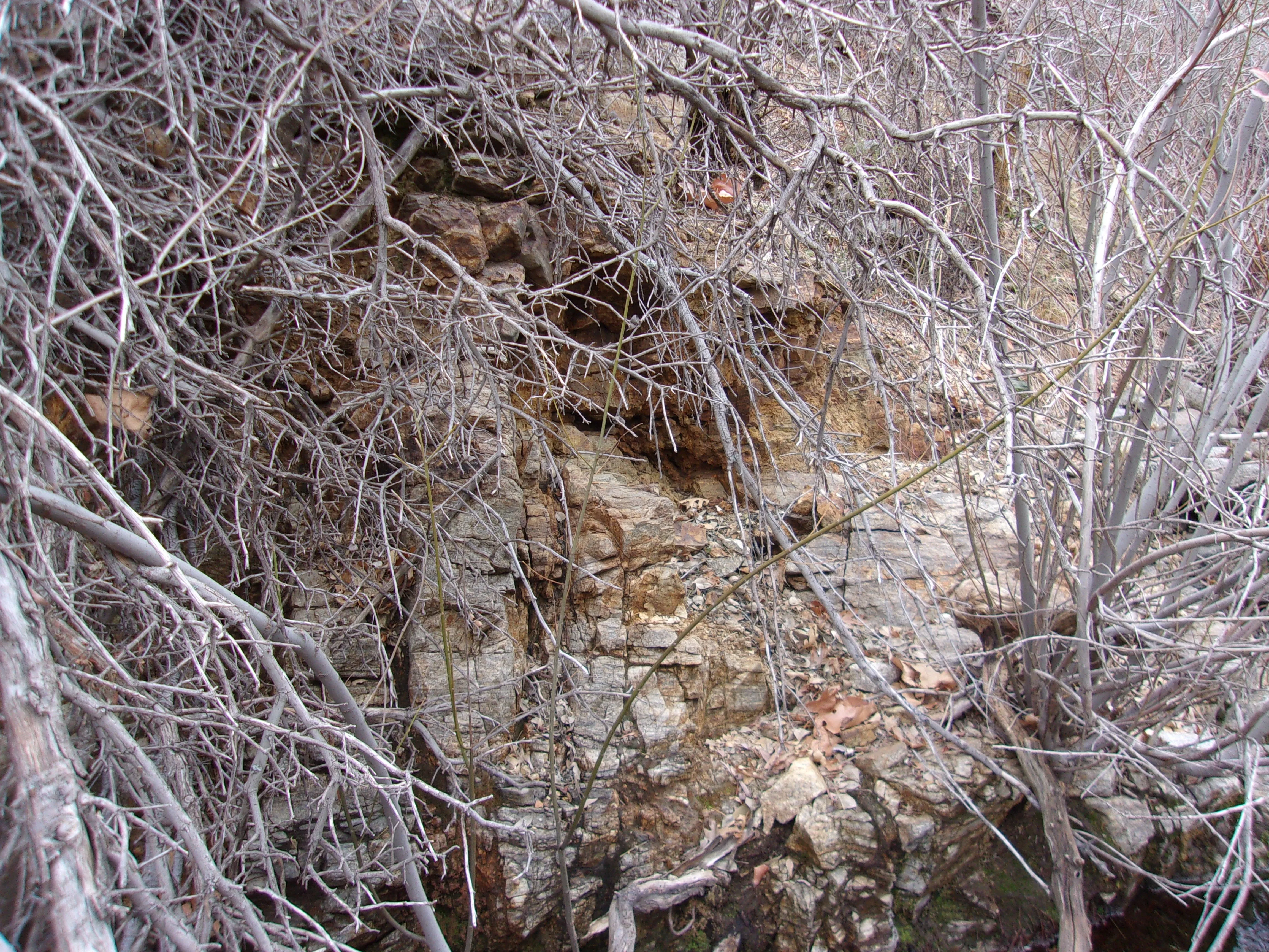

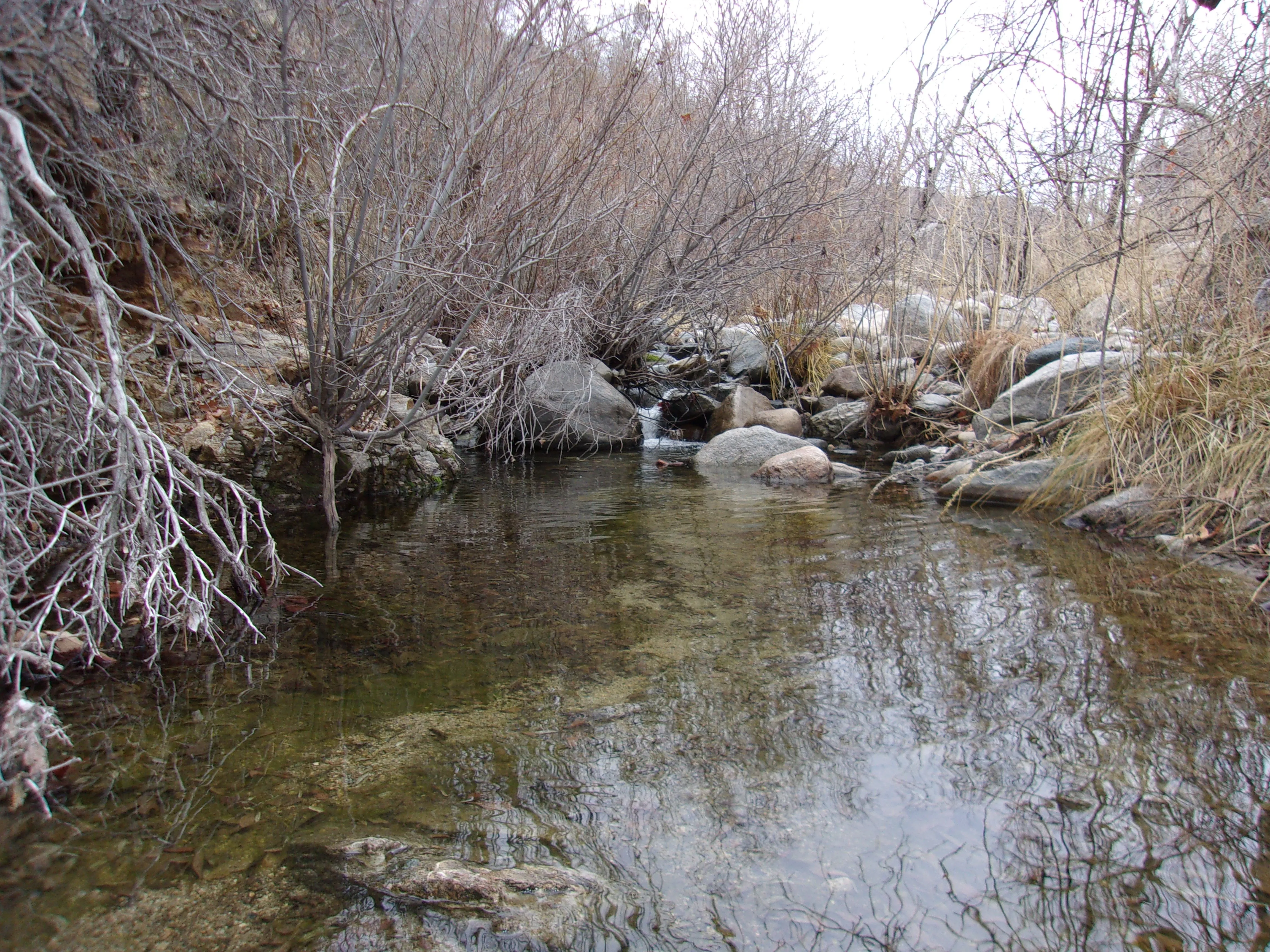

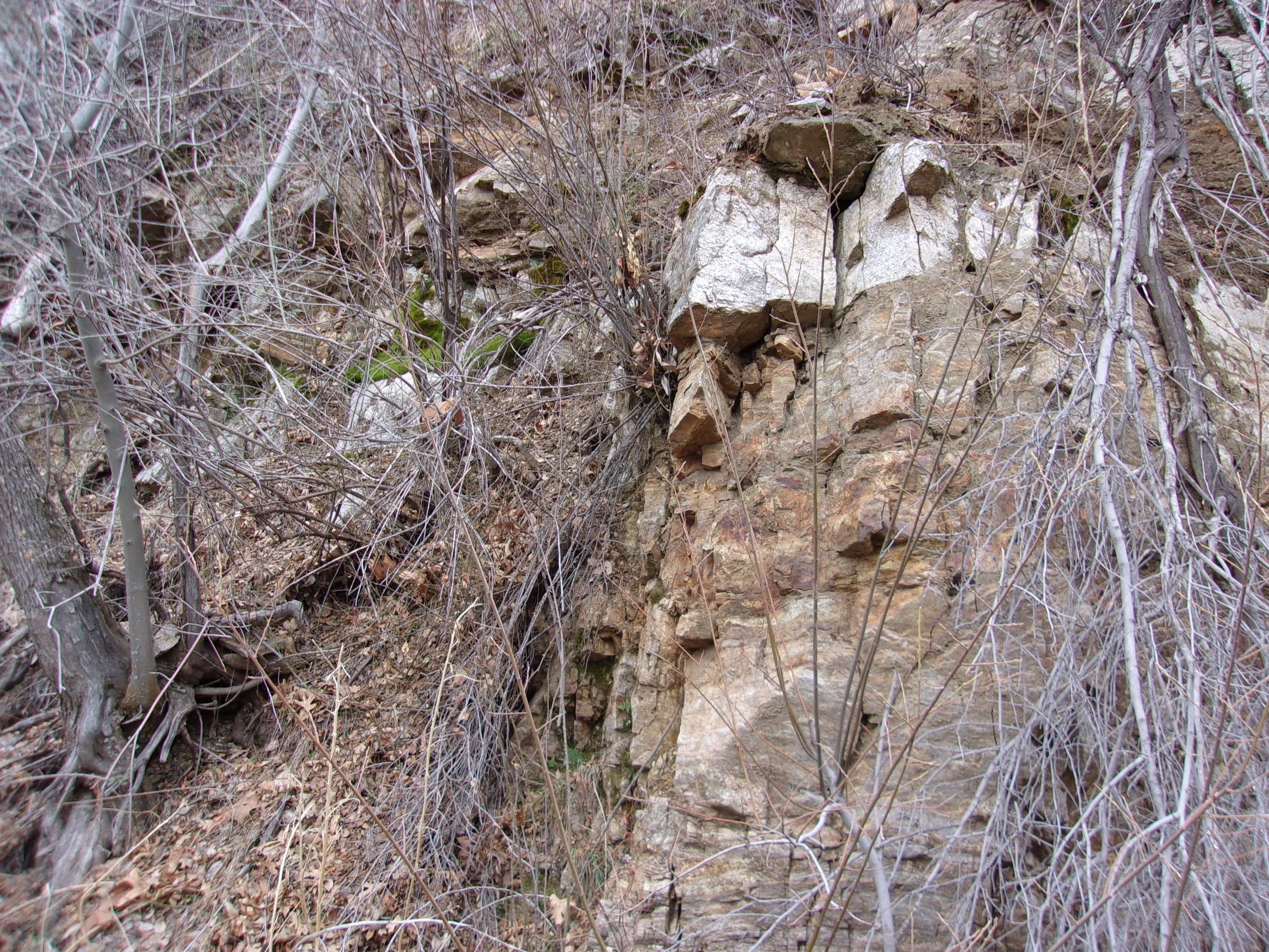

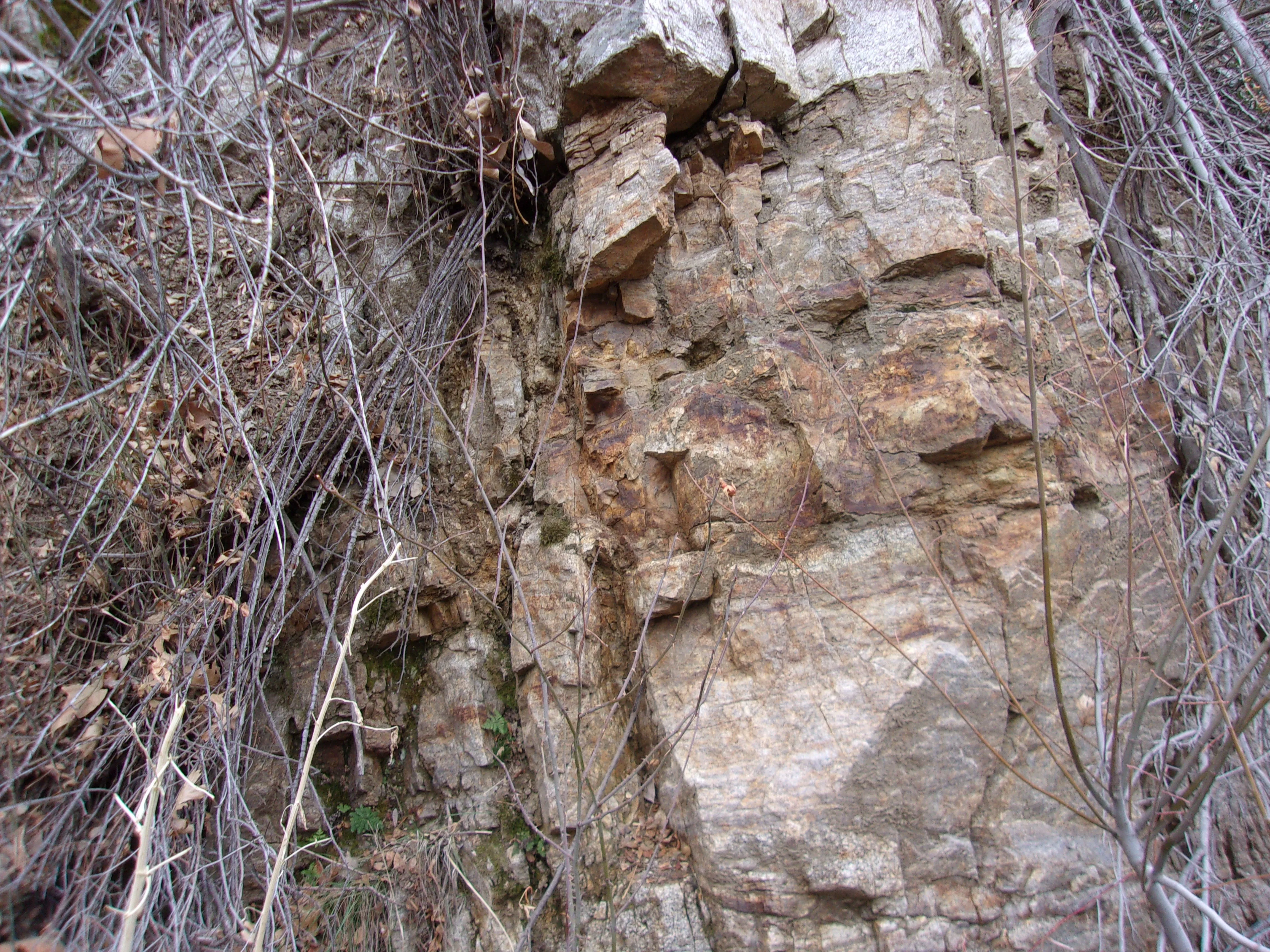

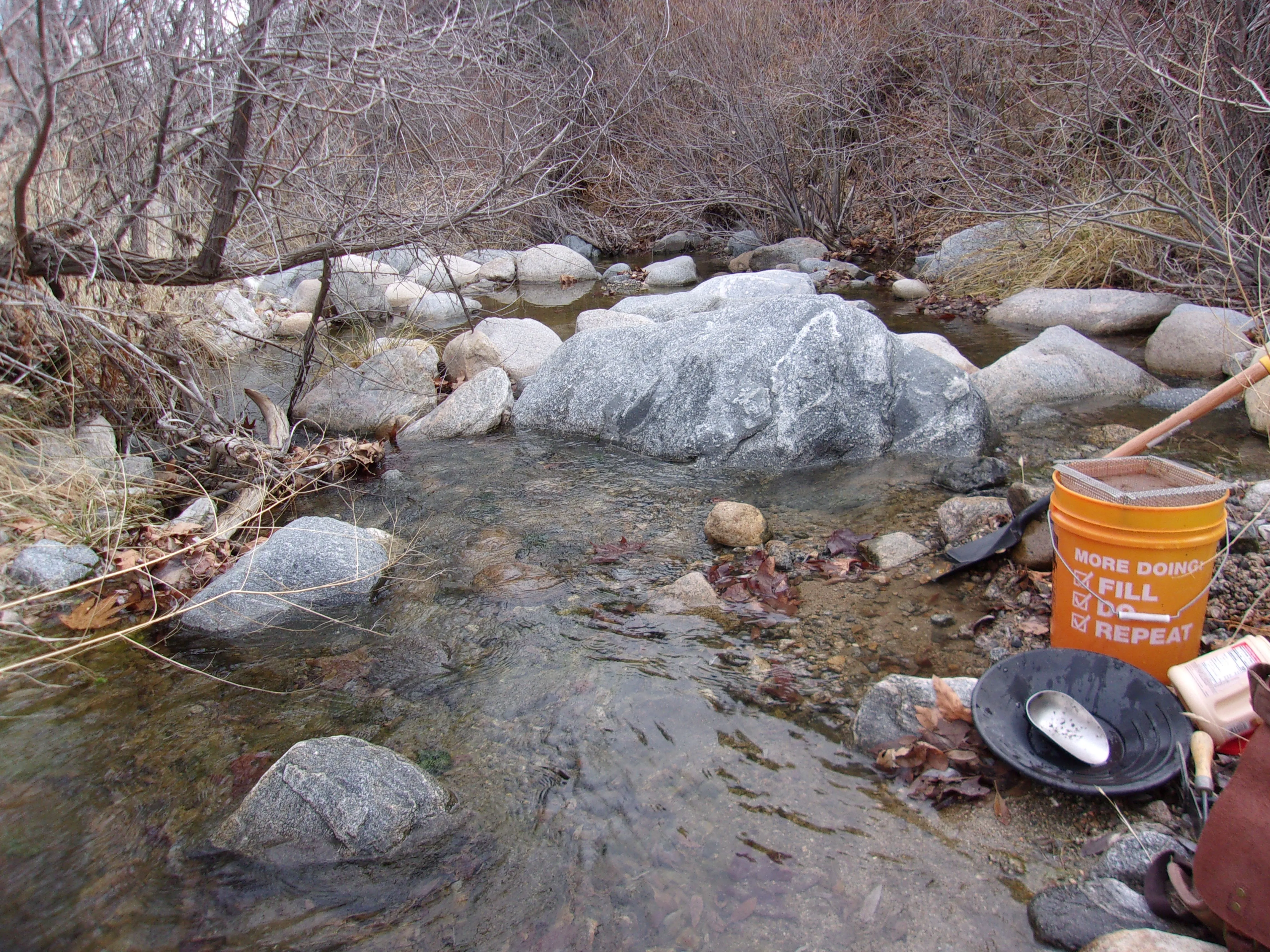

Well i went to this spot my buddy found up River. I did 4 test pans and not one speck lol, one area i tested was on the rock face where good Mineralization was occurring it had a orange rust appearance. I did run some materiel through my little sluice, almost finished panning the con's no gold yet. Any way here are some photos of this area.
