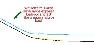

I'm not super experience but here's what I understand: In rivers, like Kevin said, the water will slow down and drop gold when it goes from steep to flat because the water doesn't move as fast, this works for width of a river/stream as well. Other thing that's on a smaller scale usually is where there's little drops in bedrock it can act like a riffle and gold will sink down behind it, I made some drawings for you.

so after the elevation drop is complete is the place to start? I had it in my head that in the slopes is where it's usually washed to bed rock and wouldn't that trap a bunch of gold, keep in mind i am as new as newbie gets. lol glad i asked

Correct, where the water is fast it is more likely to be stripped to bedrock and if it's irregular then it will trap gold and be good for crevicing perhaps. Down in the flatter spots though is where gold will simply just drop to the bottom without a trap simply because the water can't push it along anymore. Both areas potentially hold gold, just different types of prospecting. As far as google earth prospecting, I do it all the time, but it can only give you a very general idea of where to go, rivers are so variable that you really have to get on the ground and test to find out where the gold is going. Also, I wouldn't trust google earth elevation data to me more accurate than within 10, 20, maybe 40 or more feet of the actual elevation. Gold is predictable, but those rules it sometimes follows are really only guidelines. You're going to here this a million times, like I did, but gold is where you find it :tongue3:.
