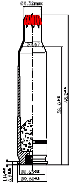

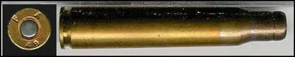

YES! I too am rethinking my position. This does look more like a modern blank round than a WWII vintage. Here are some pics. First is a diagram with measurements for a .223 blank round. Next are two pictures of 30-06 blanks. Not even close.
Hey SgtJH, check those markings and measurements and let us know.

Here's a detailed diagram of the shell. Please disregard the poor quality of the diagram... I am using a laptop which makes things a bit difficult at times. NOTE: The shell I found does have a crimped top to it, unlike the shell in the photo that gollum kindly provided. However, the dimensions of my shell are remarkably similar to those in gollum's diagram that he provided.
