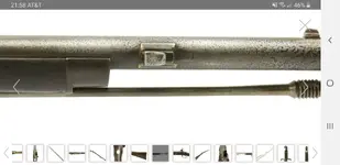

I just had an afterthought, does the rifle have a bayonet lug or not? Should be on the side of the barrel like seen on this one. If so this is the type of bayonet it would have been issued with, a British P-1856 Yataghan sword bayonet.

No bayonet to match this one. There were a couple in the closet but none for this. I had read where the VR typically says a no by a guy who wrote the book on enfields but he also said never say never as they do appear early on from surplus. Early on many of the stamped with VR were surplus and everyone was willing to make a dollar.The soldier was from Va but moved to Ill and joined there.
