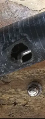

Straight shafts suit some folks. They must be either one piece or very carefully and robustly designed - just check out Andersons shafts. Their multi piece shafts are much better designed than the Nox. This is needed because straight shafts create twisting forces at every swing reversal (caused by the axis of force from armrest thru middle of handle being angled so as to lie above and at an angle to the rod-coil axis).
The Nox shaft is so far not up to the job. Wobbles, twisting and rapid wear of the locking hole in the lower shaft are evidence of this ) photo from post on another forum.

Straight shafts suit some folks. They must be either one piece or very carefully and robustly designed - just check out Andersons shafts. Their multi piece shafts are much better designed than the Nox. This is needed because straight shafts create twisting forces at every swing reversal (caused by the axis of force from armrest thru middle if handle being angled so as to lie above and at an angle to the rod-coil axis).
Of course this can go on and on. I'm having no issues with my shaft. Others like you, are. Minelab is gladly honoring their warranty on shaft issues. I have heard reports of both happy and disappointed Equinox owners upon receiving their "repaired" detector shaft. Anderson shafts are superior, which is why you don't exactly get them for free. I wonder how much ML would jack up the price of the Equinox if they subbed the shafts to Anderson? Glad ML went with an affordable overall design the enables me to make the choice of whether or not to spend the extra dough to upgrade. I bet most park and relic hunters are doing just fine out of the box.
On the other hand, if I was going to dedicate the Equinox solely to water hunting, the Anderson shaft would be my choice for the long haul because of the abuse salt water hunting puts on a detector. For occasional dipping, mine has worked fine. Other dedicated water hunters who post here and elsewhere are using the stock shaft without complaint. Like I said, ergonomics is a personal thing, no detectr company is going to get it 100% right for 100% users.
