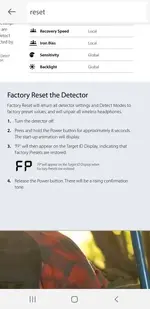

Have you done a factory reset? You can do that yourself. Here it is from the manual. Screenshot_20200929-170555_Adobe%20Acrobat.webp
I would try the factory reset and if it does not work, the only option is to send it back for repair or replacement. I have not heard of this issue before.
Thanks, that's what ML recommended too. I'll give it a shot, but not hopeful that it'll fix it.
