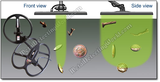

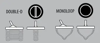

When using a DD coil think of this picture:
Double-D Search Coils

Here is a image showing what I am talking about. See I'm used to targets being in location #2 (with a concentric coil 95% of the time)
I believe if you back off the target and wiggle forward as deepseeker said the targets are in location #1
Of course this would probably work in reverse as well and the target could be at the back of the coil.
Pinpoint audio and ID could sound the same with the target in anyone of these 3 locations or in any location of the front view of the picture Jacza posted for that matter.
So you have to find the method that works best for you but normal method of beep turn 90 degrees and beep again and dig wasn't good enough. The wiggle back/forward method seems like the way to go.

It's easy to see why a DD coil can be much better than a circular coil at depth, but you need to use an X pattern to center your targets even in pinpoint mode.

I think the concentric coil has some advantages, when a coin lies on edge or diagonal, because the DD coil can only receive signals that are reflected straight upwards whereas the concentric outer coil receives from all directions, what the small inner coil has send to the object.
