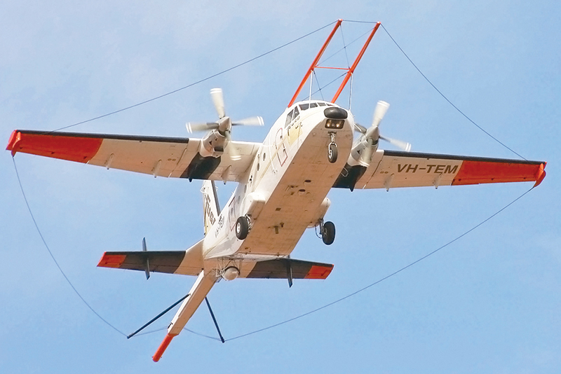

How much are you willing to invest in the necessary equipment?
https://csegrecorder.com/articles/v...ient-em-system-applied-to-mineral-exploration
