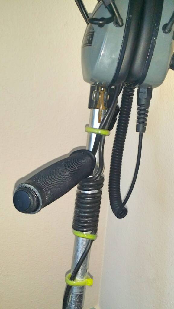

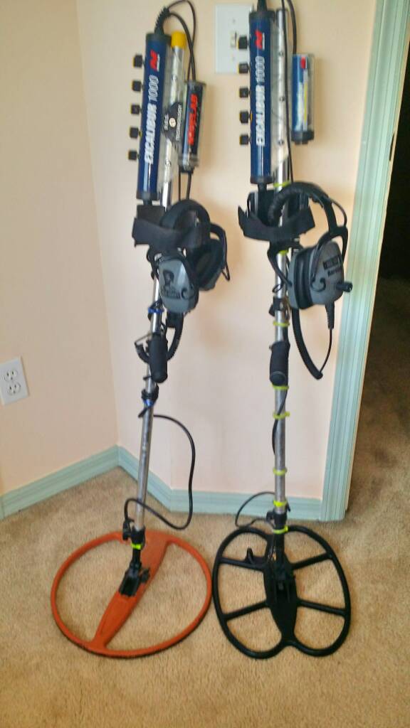

You can make your own balanced straight shaft for $25.00, easy to make and I replaced all my knobs for $5.00 total of $30.00 additional investment. With straight shaft no need for hip mount which puts stress on cables...
I will take the null feature every time, I have yet to see it wrong after testing it hundreds and hundreds of times over the years, maybe 800-1000 less holes dug over the years and I have found gold in same hole as iron by doing the 90 degree re-sweep trick explained in manual.
By installing the reverse discrimination mod after warranty expired I can hunt in pinpoint mode (all metal) and with a simple flip of thumb switch located on hand grip I can switch to discrimination to see if target is good or bad and getting more depth and still digging no iron.

Whereas on the CZ-21, you simply hunt in Autotune (all metal) and switch to Discrimination to see if a target is good or bad, all by using the nice little knob that is included on the detector...no mod needed. :) Lots of people say that their CZ-21's actually go deeper in Discrimination than Autotune, too...I have no clue about that. If mine beeps a mid or high tone, I dig...that's all I know, really.
So how does one hunt on the Excal if they do not want to mod the device...is there no all metal setting like autotune on the CZ? I had assumed it was like the autotune on the CZ but it just nulled iron. On the CZ I hunt, and I think most others, hunt is all metal using autotune then we flip the switch to listen to what kind of metal it is. How is it done on the Excal without the mod? I know the tones on the CZ are not as sensitive as the autotune because in autotune I can find targets that I might not necessarily be over but rather just near.
Pinpoint is all metal. You turn selector to pinpoint your in all metal mode.. It only nulls on iron in descriminate mod. The purpose of the mod is to put the pinpoint switch on the handle so to switch between pinpoint and discriminate is just simple flick of thumb switch on the hand grip. Several inches deeper in all metal.
You hunt in all metal when target is found you hit thumb switch to switch to discriminate to see if target is iron, always sweep twice, 2nd time from a 90 degree different direction, if there is gold with iron it will sound on 2nd sweep from different angle..
If there is no tone on discriminate remove scoop of sand and sweep again. All metal is deeper and may need to remove some sand till discriminate tones good or bad...
Wow that switch is pretty cool and that's what I thought about the all metal but just wasn't sure. Those machines look awesome with those coils. The excal is definitely the best looking metal detector imo.
