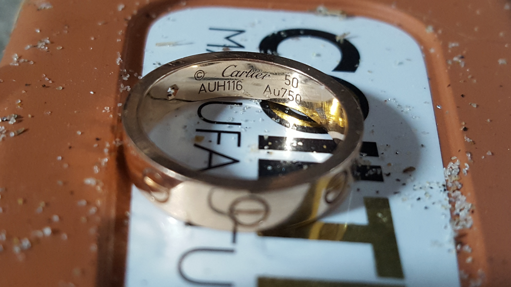

nice ...One of my excal hunts. Cartier 18k
