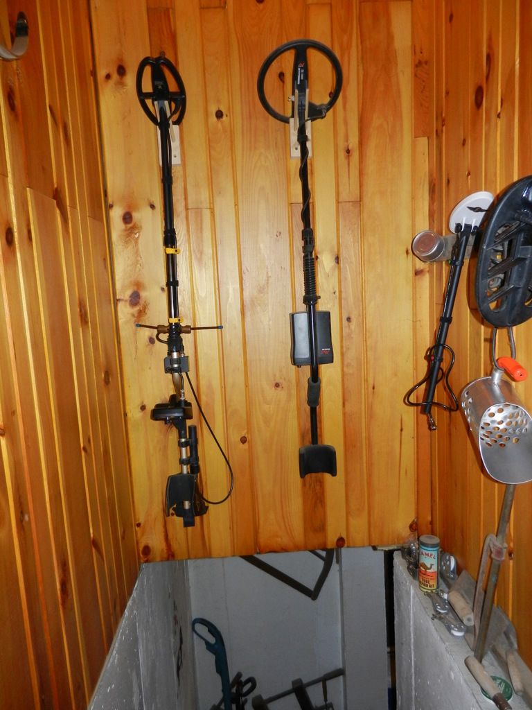

I have an F-75 and the stock 11" coil, a NEL Sharpshooter and a Fisher 6.5" oval/concentric.
I leave the NEL on most of the time. The little concentric is VERY nice in trashy parks and picnic grounds for shooting in among the junk. But the NEL is my overall favorite. It does well in trash provided you "X" around a bit if you get a semi-solid hit. The Sharpshooter seems every bit as deep as my ''" coil but is substantially smaller.
Here it is next to a 10" DD.
