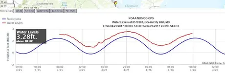

With all good replies also remember this, Weather will also effect the tides. Strong winds one way or the other can push the tide time up or back. From Table 8-Tide Prediction Accuracy of the 2017 NOAA tide predictions "Baltimore -Winds Greatly affect the times of high and low tides, owning to the large shallow bay and small tidal ranges. Gulf of Mexico locations-Water level is difficult to predict because the Gulf, being large, relatively shallow, and with a small tidal range, is greatly influenced by weather conditions."
In addition any deep dredging in an area, like ship channels for instance, can also effect tides and currents.
