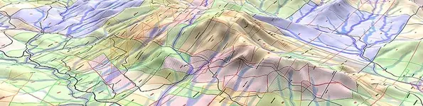

hehe... You mean something like this only current?
