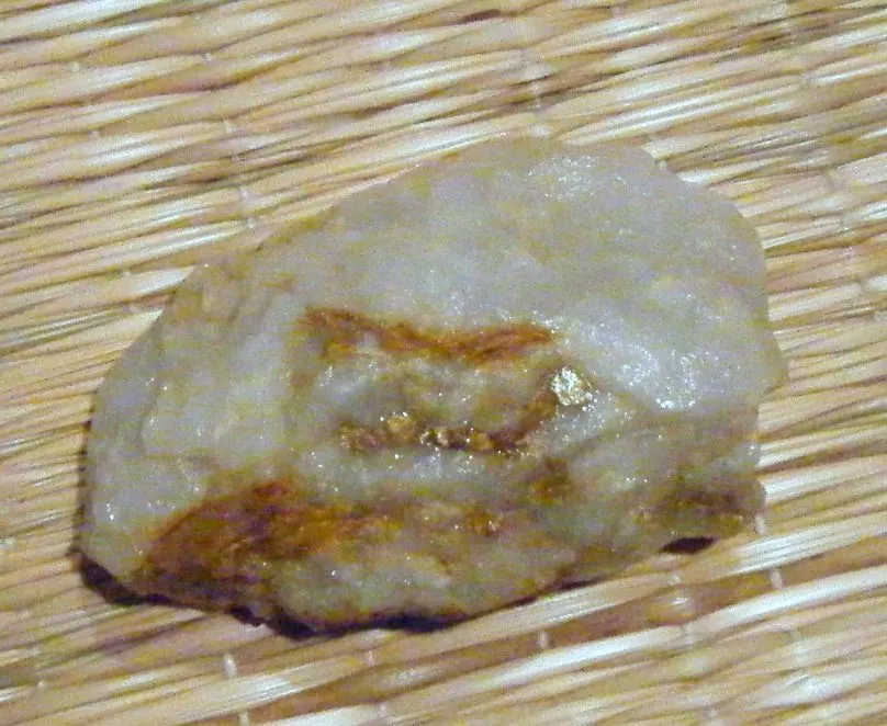

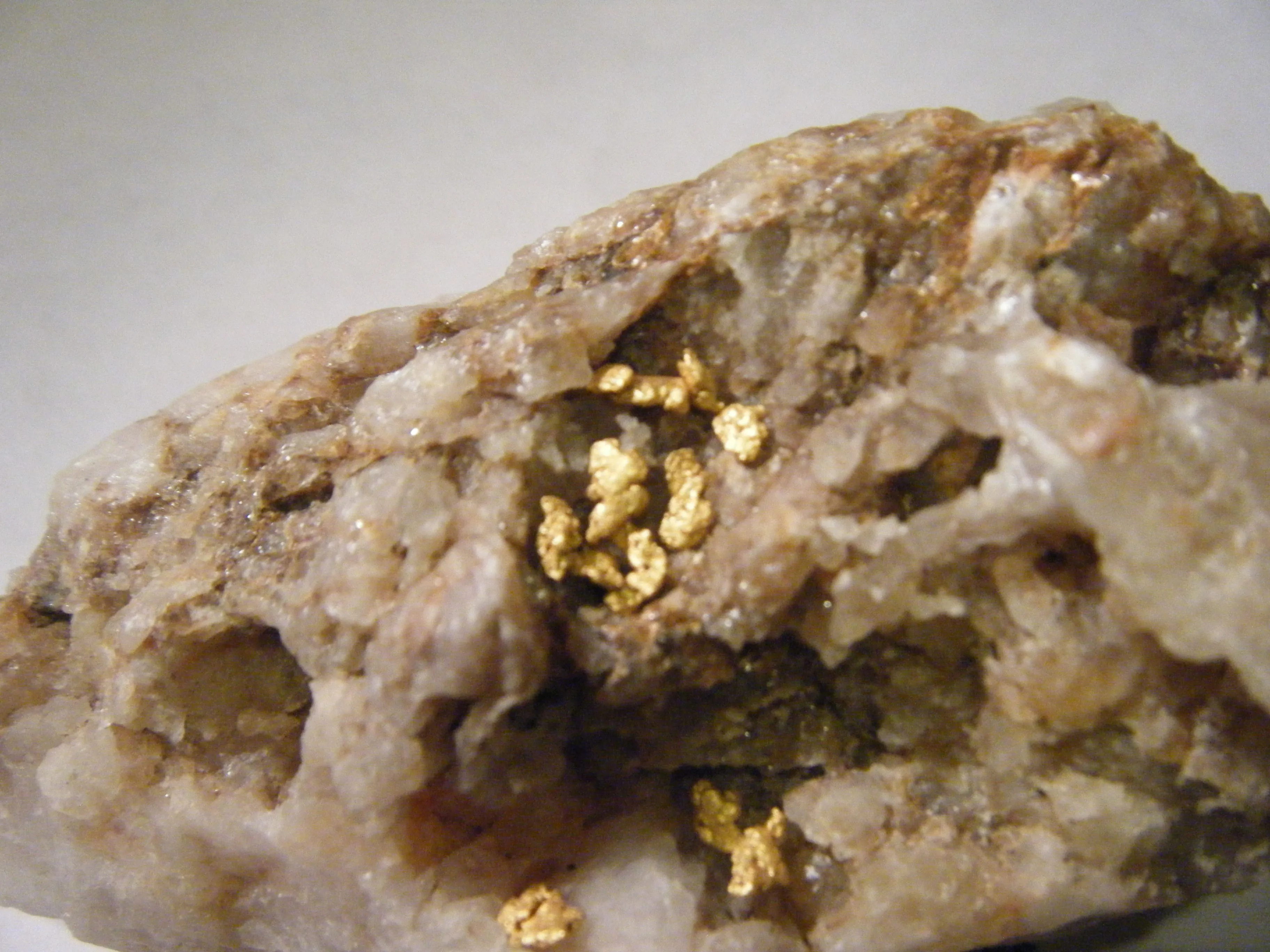

The "Darker",,,, the quartz,,,, the better... :icon_thumright:
The "Darker",,,, the quartz,,,, the better... :icon_thumright:View attachment 2060599View attachment 2060600
RTR, so the white quartz has a lot less chance of having gold than say dirrty quartz. Too bad our claim has been picked over so much for over 100 years. There might be specimens like in the picture, but they are probably buried deep enough that no metal detector is going to find them, You'd just have to dig, and hope.
Yeah but, what 'looks white' on the outside isn't always whats going on in the inside. My 2nd. pix above(quartz rock split in half w/a hammer) is the inside of what looked almost completely totally white quartz on the outside.The only way I found it was with the Falcon MD 20.:icon_thumright:
