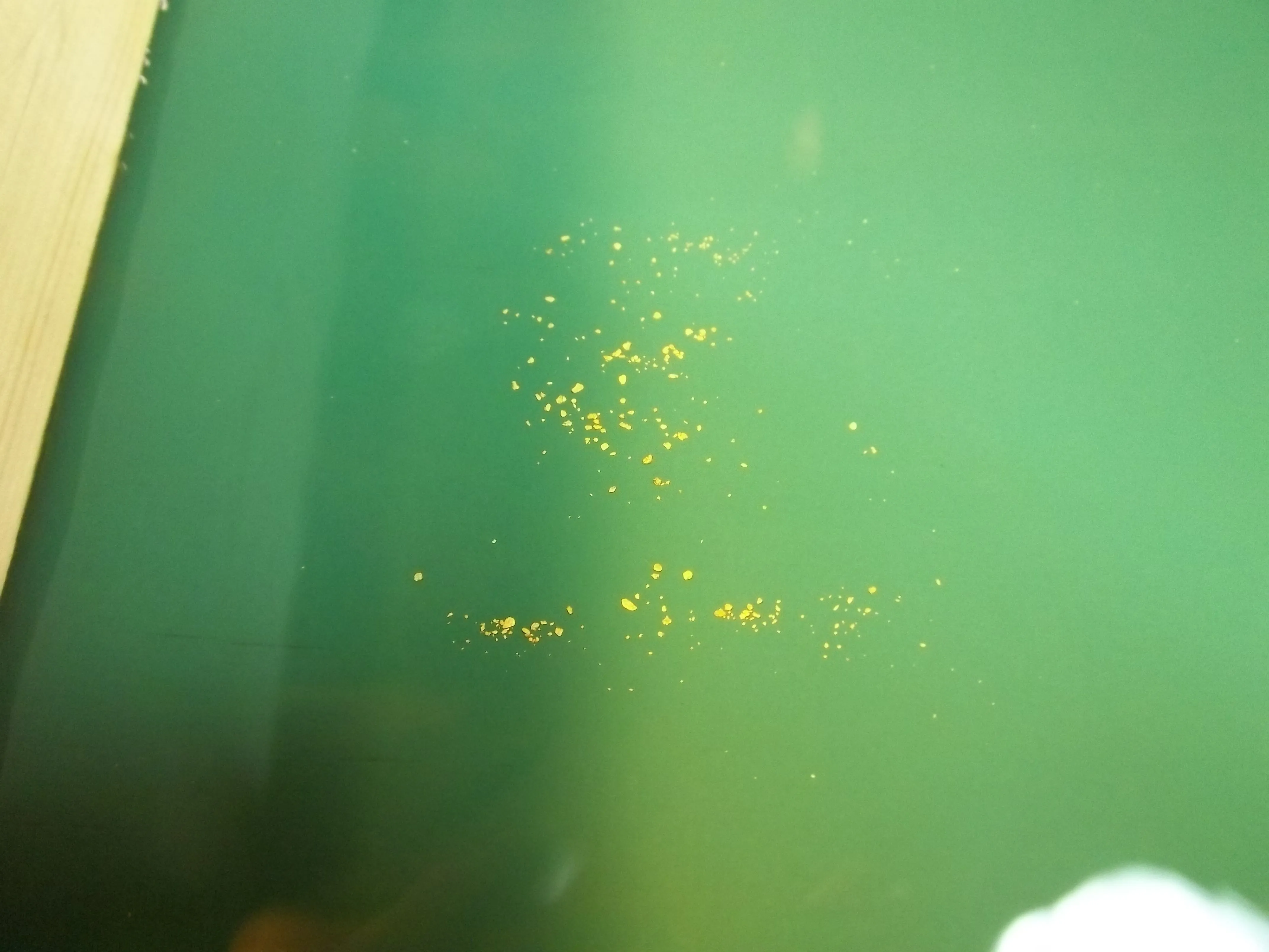

Try adjusting water flow on that Miller & or angle of table.These magnified specs (ultra fine) are so small they
float on water. caught by my Miller :):icon_thumright:My homemade Miller is 4ft long with an overall (end to end) drop of 4 inches and it catches it all :) Good luck.
Every time you screen that material ,try pulling the magnetics out as yo0u go and SAVE those magnetics for later refining ! Redo the removal of the magnetics several times and the fine gold will show up the more times you do this and , THEN try out the Miller Table and as had been previously said , alternate the water flow (SMOOTH AS GLASS ) to barley running for the REAL FINE stuff ... and then try changing the angle of the table and don't toss any of them undetectable fines that's left over !! It all adds up ! you will see the fine unseen gold when you put it in the kiln as a small bead of gold ! Good Luck and Happy Thanks Giving to all !
Try adjusting water flow on that Miller & or angle of table.These magnified specs (ultra fine) are so small theyView attachment 2056653 float on water. caught by my Miller :):icon_thumright:My homemade Miller is 4ft long with an overall (end to end) drop of 4 inches and it catches it all :) Good luck.View attachment 2056654
Actually, that gold in the photo is huge, compared to what I've found. Some of the gold is so small, it's barely visible with a 10X loupe, and all I've found isn't visible to the naked eye. Not saying what you show in the photo isn't small, but it just doesn't look as small as I describe the gold I've panned.
