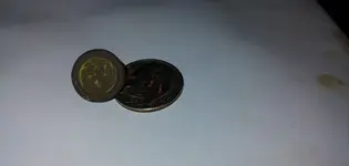

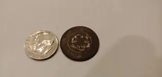

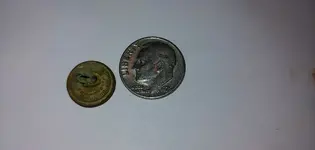

Hello all,
After my first week of poking around an old cabin site, have found 3 pennies, 1826 to 1831 and 22 buttons. No problem identifying the standard, double and treble gilt. But 2 buttons came up that I can't seem to get any info on. One has a stamped front with what looks like silver in the indentions, and the other has an eagle on the front holding a shield with no gifting at all. The eagle button is very small like a collar button. Any help would be appreciated. Thanks

the last one reminds me of a jacksonian button, which would be 1830's ish but im a novice button guy so ill defer to others if they disagree
Your brass 1-piece flatbutton with silver plating (gilt means gold) and no backmark is a Civlian-usage one which button collectors call a "flower button" when it has a floral motif and a "geometric button" when it has that type of motif. Yours dates anywhere from the late-1700s into the 1830s. After that time, 1-piece buttons rapidly fell out of favor with the public due to the advent of inexpensive ornate 2-piece brass buttons.
Older_The_Better's guess is correct... your other button isn't actually a 1-piece, because it has a thin applied brass ring encircling its edge. Button collectors call that type a Jacksonian button because it was popular during the US Presidency of Andrew Jackson (two terms, 1829 through 1837). No Jacksonian buttons were Military-usage. They show flowers, or an animal, various railroad engines, farm-field scenes, or a "patriotic" motif such as the American Eagle. Here's a photo showing some of the many emblem variations seen on Jacksonian buttons.

Your brass 1-piece flat-button with silver plating (gilt means gold) and no backmark is a Civlian-usage one which button collectors call a "flower button" when it has a floral motif and a "geometric button" when it has that type of motif. Yours dates anywhere from the late-1700s into the 1830s. After that time, 1-piece buttons rapidly fell out of favor with the public due to the advent of inexpensive ornate 2-piece brass buttons.
