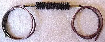

Forty years ago, I dug one EXACTLY like yours at an 1864 civil war battlefield in North Georgia... and others have been dug from civil war sites. I capitalized "exactly" because some small details of the bore-brush's form are very important for determining its correct ID. Note that its brass attachment-end is threaded, to screw into another metal part. Also note that there is a slot where the ends of the twisted brass wire fit into the attachment-end. Its overall length is also important. Internet research shows there are several slightly-different models of this bore-cleaner brush... some of which are from slightly after the end of the civil war. See the photos below, which show a US Model-1866 carbine bore-cleaner brush, and a Model-1873 brush for the US .45-70 Springfield Rifle, and a "Sharps Carbine" bore brush with no model-date. Remember, the brass brush's overall length is important when you view these photos. (You'll have to check the photos' file-name for the model and date info, because I don't know for sure what order the photos will get posted in.) Note that some have a leather thong which is connected directly to the brush's brass attachment-end. Other have a threaded end, which screws into the brass ferule on the leather thong. I can't find any which a labeled with certainty as being pre-1866... but I can tell you that more than just a few have been dug from civil war battlefields and campsites.
I must mention, I think that some (but not all) of the McPheeters website's identification and dates of these bore-cleaner brushes is inaccurate. I hope somebody here already knows or will have better luck than I did in researching the ID of these long-bodied, threaded-end bore brushes than I did.
  • guntool_bore-brush_US-carbines_single-thong_Mcpheetersantiquemilitariadotcom_cwrodset.webp
  • guntool_bore-brush_Sharps_double-thong_Mcpheetersantiquemilitariadotcom_sharpbrush_1.webp
  • guntool_bore-brush_US-Carbine_single-thong_WIRE-SLOT-IN-FERRULE_1861-1872_Mcpheetersantiquemi...webp
  • guntool_bore-brush_Springfield45.70-Model1873_single-thong_Mcpheetersantiquemilitariadotcom_7...webp
  • guntool_bore-brush_Springfield-Model1866_no-thong_rod-mounted_Mcpheetersantiquemilitariadotco...webp

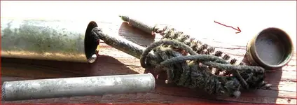

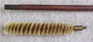

To help avoid confusion in researching the correct ID (and time period) of the rifle/carbine bore-cleaning brass brushes, here are two photos of first-half-of-the-20th-Century ones. The first is a Model-1903 Springfield Rifle's bore brush, and the other is a World War 2 US M-1 Garand Rifle's bore brush. Both of these have copper/brass wire bristles.
  • guntool_bore-cleaner-brush_1903springfield-rifle--cleaning-kit_TN_postedbyDCMatt.webp
