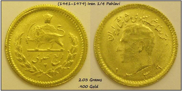

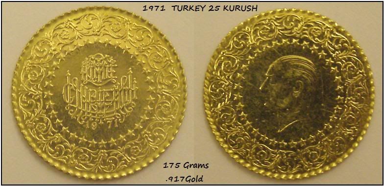

Before gold sky rocketed a few years back, I often bought a gold coin with all my pennies, and now have about 10 gold coins.
A darn good move that was as gold prices including coins went through the roof.
Here are a couple of the foreign coins I had purchased in the past.
