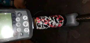

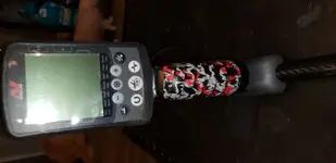

I'm not a fan of the nox handle. It's not really comfortable to begin with and in the Oklahoma humidity it becomes super slippery and I find myself resetting my grip over and over. I tried a few other grips (bike, "injury tape", etc), then it hit me. If any of you fish, or if you golf which was their initial product, you are familiar with Winn Grips and I decided to use some of the Winn Grips Rod Wrap I use on my crankbait and heavier rods. If you have never felt Winn grips, think of a tennis racket grip, yet a tighter wrap and more cushion. Since the nox doesn't have a round handle it took some trial and error to get it correct but now I got it; tight, no gaps, looks and feels great! You can get the rod wrap on Amazon in a myriad of colors and patterns for about $19 and it would wrap 2 nox's. It comes with enough wrap along with 4 "finishing" tapes so it looks great. If you are interested in how I wrapped it just ask.

Like I said in my first post, I tried many different wraps including vet wrap. I have about 100 hours on the grip you see in the picture and it's still tight and cleans up as new.
Great idea for dirtdiggers, but no so for waterwalkers.
From Winn: "DO NOT immerse Winn grips in a bucket of water to clean them. This will saturate the underlying layer of the grip and may ruin the grip."
