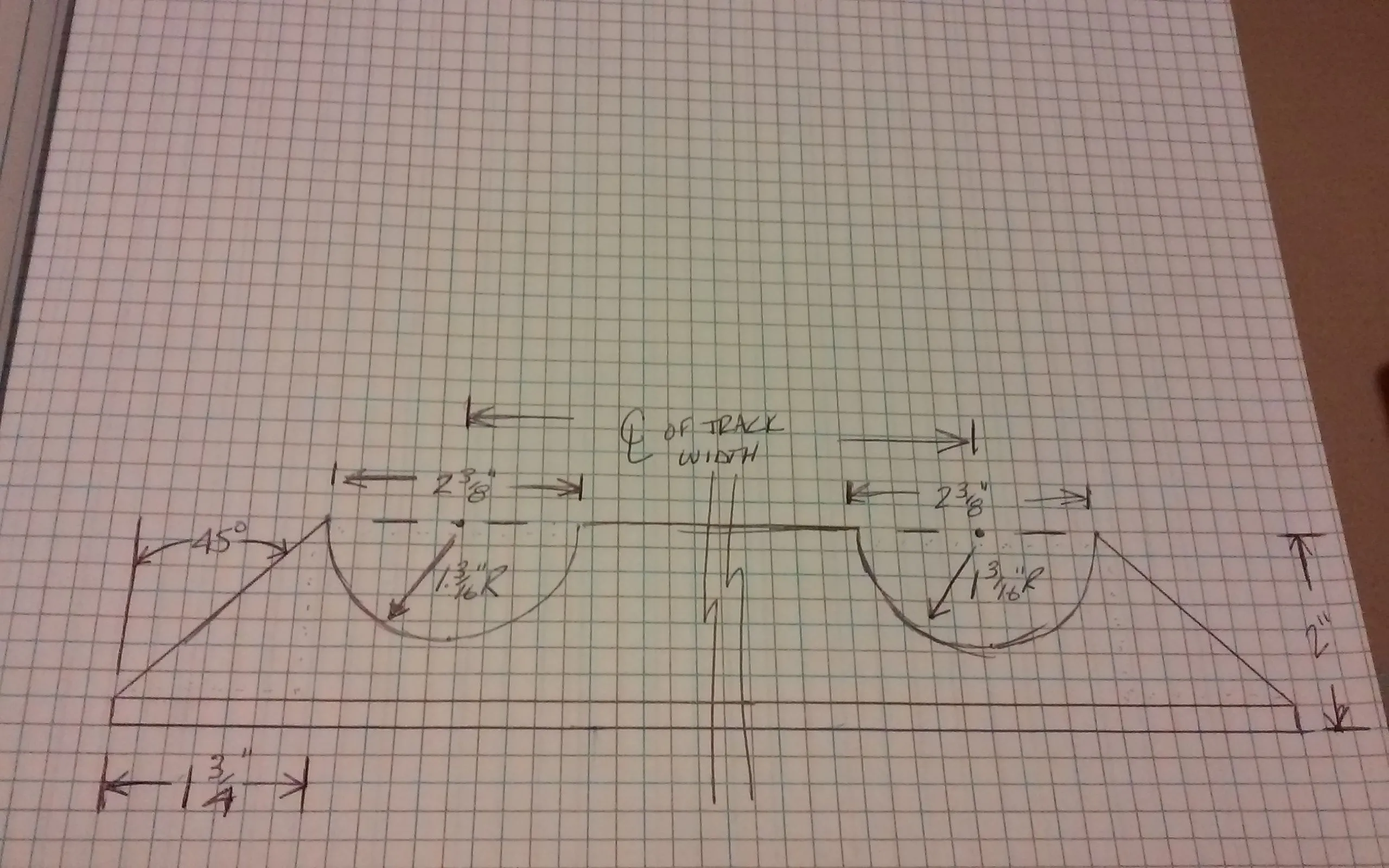

I've thought about this a lot. And if it was me, I would run the v groove swivel wheels on 2" pipe. An anchor plate can be made from a piece of angle. Make the anchor plate about 4 or 5" wide and taper the ends up at a 45 degree angle. Use a bimetallic hole saw to make a cutout for the pipe to sit in and weld it to the pipe. Ideally the 45 degree ends should be right around halfway up the pipe when installed so they will clear the v groove wheels when they roll by.
Clear as mud? If not I can draw a picture and put it up.
If you could draw me a picture, I'd appreciate it for sure.

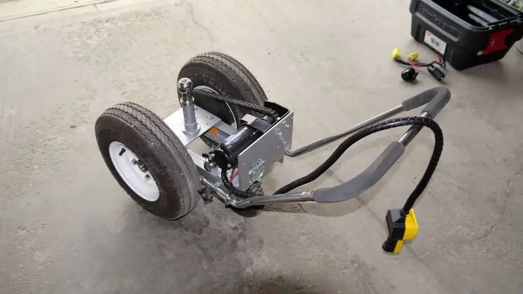

I was thinking about your cart idea when the image of an aircraft tow tractor popped into my head. They also make battery powered trailer tow rigs of similar intent.

Here ya go.

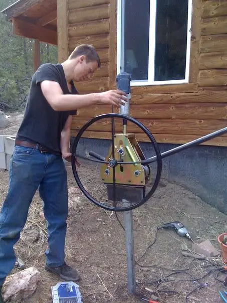

Cut the radius with a 2 3/8" hole bimetal hole saw to march the od of the 2 inch pipe. Set the center of the cutouts to the width of type tract you want. Weld the pipe to the 2" angle. Drill holes in the bottom leg of the angle to lag to a 4x4.
The angle at the ends of the track should be turned so they can be bolted together for additional lengths to be added. Depending on the center to center distance between the cross ties, this should be a rather strong but still lightweight system that is both easily built and assembled by one or two people if the lengths are kept reasonable. I'm thinking if it is setup right the "track assemblies" could easily be moved around on top of the ore carts.

https://m.youtube.com/watch?v=VaWrE3-MhXM
Put one of these on the track system we are talking about to use as a tugger.
I think we have a winner there. Runner up goes to jcaz with his truck winch tugger.

Here ya go.
Fever broke this morning around 4 am. For some reason I had thought you were cutting the holes into the heel of the angle and then just using the angle as the cross tie on the sill. This makes a lot more sense, sans inner ear infection.
Cut the pipe down to 10' sections, and this could be fabricated using an oxy-acetylene rig on site as I'll have my welder there as well. A few of those alcoves right up in front of the adit are going to make good little storage areas once I put some steel doors on them. Of course, the mine will have a beefy front gate too.
