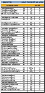

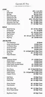

Who's got that VDI chart lol, I know I just saw it on another post. :icon_scratch:
Found it, thanks... Didnt know there was such a thing as a "VDI Chart"... so now how do I delete this post?
