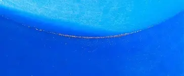

I got my Gold Cube mid December and finally got a chance to try to run some cons thru it. That's Alton Oakes (Colorado Springs GPAA) classifying at 1/8 mesh, and doing the panning.
We got an exceptional amount of black sand out of the 2 buckets of cons we ran thru and the gold was flour fine (100+ mesh). I will be hitting up more club members to run their cons with before summer to see what affects what.
I did not buy the stand with the GC - I need something a bit more extreme for where I plan to take my Gold Cube this summer. Its sitting on a piece of plywood and a cinder block for the time being. 1200 gph pump and a 12 volt battery.

Additional cleanups (using concentrates - its a bit cold in the Colorado mountains right now) from Clear Creek Colorado. The resulting black sand is full of fines, and it ends up like a thick and hard to work pudding, we ended up panning out a table spoons worth at a time. We ran the material 2 times and there was only a few very tiny flecks that showed up in that cleanup. 1/8 inch mesh screen used as we were feeding the Gold Cube.
