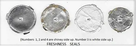

Hi Digger27 !
With reference to the next-to-last paragraph of your post #15, where you are referring to the disc. setting and say "about as high as I ever go is that 20-21 freshness seal foil area", I decided to run tests with my Tesoro Compadre and Teknetics Gamma 6000 digital TID, to see what signals these would report on (4) sample freshness seals shown in the attached photo below. I peeled seal #1 from a new bottle of CQ-10 and #2, 3 and 4 were all dug previously and saved as future test samples.
Test results are listed below and were performed in the yard behind my apartment and test setup conditions were as follows:
⦁ Gamma used in AM mode to find clean area and Ground Balanced using the automatic "Ground-Grab" which gave a reading of 53 (Yellow clay with moderate mineralization).
⦁ Grass pulled to make bare spot of earth, all freshness seals layed flat on earth, silver side up for individual tests.
⦁ Gamma setup: Coil Teknetics 5" DD that was on detector from recent hunt at trashy park, Disc. mode, Disc. level 01, Sens. 94 (no sound), Tones at 2, Volume at Max. 10.
⦁ Compadre (5.75" Coil) operation: Hunting in All Met. mode. When hearing target signal thumbing the dial up the arc a little ways past where the target signal fades out, then thumbing back down and listening to the signal when the target "comes in".
⦁ Coils scanned slowly approx. 2" above each of the four seals and readings recorded as follows: Gamma 49-50 (Just passed the "L" in FoiL). Compadre (slowly thumbing dial back down) dug seals #2, 3 and 4 gave some crackle sound when dial indicator reached the F in FoiL, then signal came in strong a hair below the F. The new seal #1 just came in strong a hair below the F and no crackle sound.
Regarding the Gamma Disc. Level, my usual setting for hunting trashy parks has been 39-40, but in the future I'm going to drop that to 20 - 24 in the Foil sector; don't want to miss any gold jewelry ! :wink:
HH !
ToddB64
