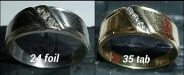

I learned my lesson long ago about that stuff when I dug this channel wedding ring on the left that was white gold, heavier and at least two sizes bigger than the similar yellow gold one I also found on the right...and both were 10k.
White gold can come in from low to higher depending on which white metal alloy the jeweler mixes the yellow gold with to get that white color.
In this case this fairly large men's wedding ring was low.

I found that white gold ring next to a very old and super trashy basketball court, the one area where I always did and still dig most signals because of the extreme trash and masking problems around these courts and the extra high percentage of jewelry possible.
I must have dug about a dozen actual foil seals on that hunt before this signal popped up.
I bent over to dig another one just to get it out of the way, or so I thought at the time.
Couldn't have been more wrong and I was pretty shocked when that ring with ice popped up instead.
I use very little disc when hunting nowadays but even if I do about as high as I ever go is that 20-21 freshness seal foil area on anything I swing because of the lesson I learned on that white gold ring.
