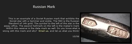

bigcypresshunter said:
Is there a tiny hammer and sickle on the star?
http://www.hallmarkresearch.com/html/archives.html
"Do you know what is wrong with this mark and why?" For one, isn't the hammer and sickle supposed to be inside of the star? I know the star was used in the late 1950s. Even then, it was inside the star.
http://www.modernsilver.com/basichallmarks.htm (the very last link also confirms it began 1959)
The only other "star" used (for 585...some US silversmiths did but had 14k), that I know of, is by Italian makers (1968-present)...but, they used a star, then a number (ID of the silversmith) and then two letters (initials of the Province).
The middle mark on the ring is too well worn to guess what symbol it is. All links to a Russian hallmark indicate that 585 wasn't used until the late 1980s, at the earliest. The "v" (if it is?) could possibly mean Kiev.
